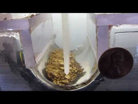

after two 5 gal buckets of classified material that was screened for a Gold Cube but not sluiced or dredged. It was brought home to work but has been sitting. gold cube gold 002.webpgold cube gold 001.webp
There are about 10 nice pieces; only 1 made it to the 2nd tray. But there should be more in-between the chunks (about 2 mm) and the tiny stuff. There was lots of dirt and therefore dirty water. Jet Dry was used Maybe all the stuff I thought should be there is on the third tray. Any ideas?

Gold cube is pretty efficient so unless you were really running things to hot , that's probably pretty much what ya got..... Of course you can always re-run the stuff, not like it takes hours to do,,:laughing7:
An afterthought .... Since these were 2, 5 gal buckets of raw classified unrun material and NOT 2, 5 gal buckets of sluice concentrates I would say you did pretty good....:blackbeard:
You were correct; that is pretty much all I got. I have figured out by looking at markings on all the coffee cans of material I have sitting around, that I kept separate the minus material from the classifying of these buckets. Hence, that is all I got.
