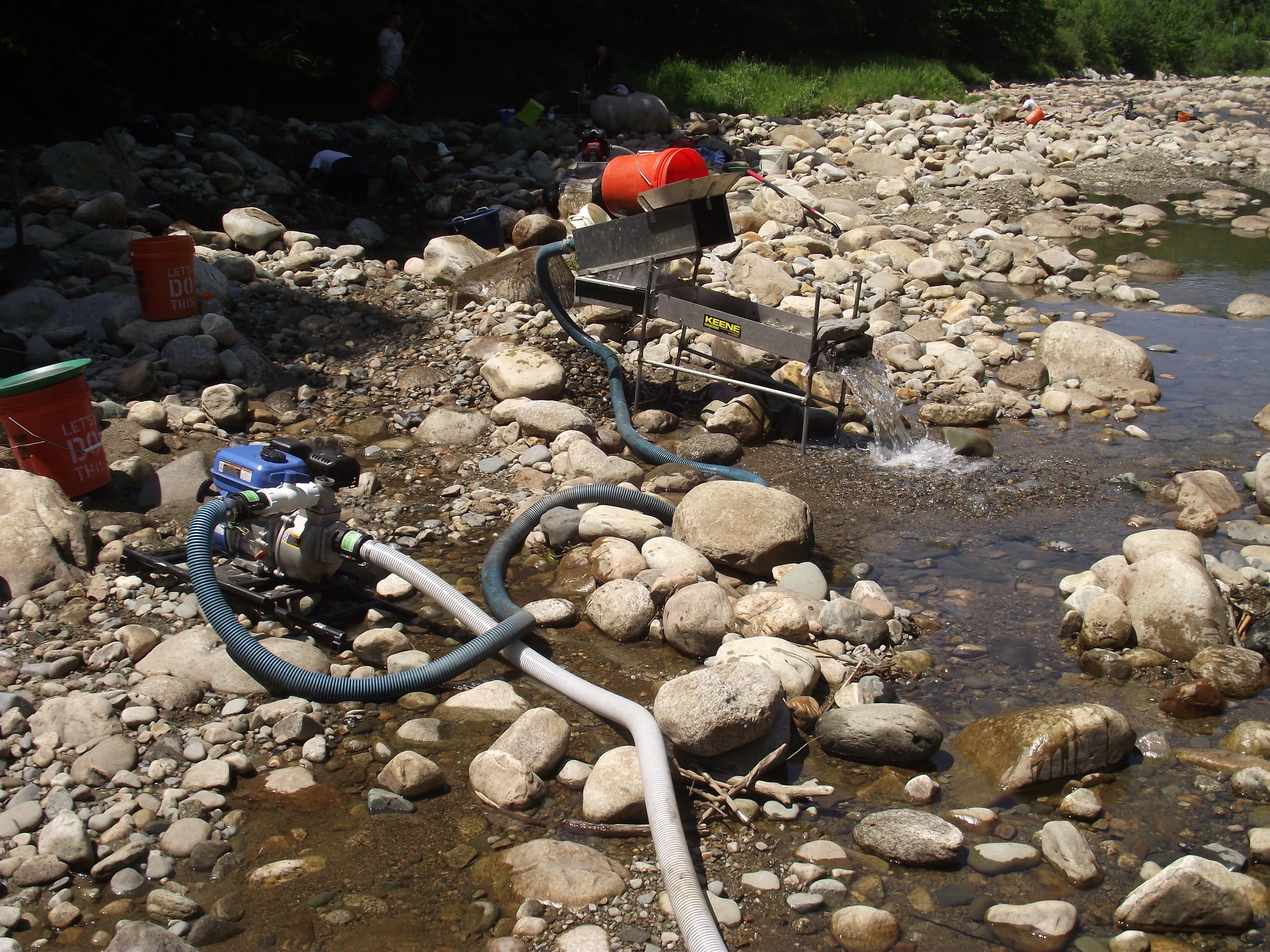

Getting this thread back on track, my NOT FOR SALE gravels are from the creek bottom, right off the bedrock. Mother Nature has already cleaned it for me. There is no bank run material or clay. Since we highbank, and it's set up right in the creek where we work, there is no need to classify as that's what a highbanker does for you. Nothing larger than 1/2" rocks hit the crash plate, and through the riffles they go. Black sands and gold are all that remain in the sluice. We usually run 4-6 hours per cleanout, depending if we need to relocate the highbanker sooner. 6pack is in the beer bag upstream for those thirty moments.

Catching gold is easy, actually you can do everything wrong with most sluices and highbankers and still catch gold. I've seen it done. Wrong angle, wrong flow, backward riffles, clay, mud, no classification, wrong feed rate, etc. and if there is good gold in the material some of it will still be recovered if enough of it is fed into the equipment. Watching Todd on Gold Rush proves that. :laughing7:
The trick is, recovering 95 to 99% of what runs through, especially if it is all fines and flour and precious little of it in the material being run. That's when all the tricks of the trade come into play. Most would not even waste their time with such poor material. But here in the mid west, where most all the gold has been ground down to fine and micro size as well as flour and powder size from glacial transport covering hundreds and hundreds of miles, it's all we have to work with.
