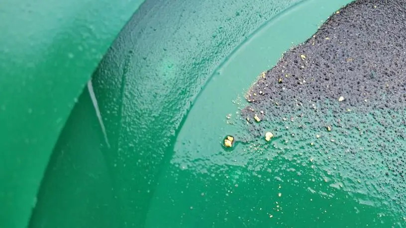

I bought for the first time paydirt. It was 5 pounds of Whiskey Petes Gold on ebay. I paid $27.75 for the 5 pounds and was super excited. I expected to get at least 10 dollars worth in gold but I only had .12 grams of gold. I sluiced it and panned it about 10 times. I couldn't believe how little was in there. I know paydirt is for learning experiences, but is this normal for 5 pounds of paydirt for that price ? He has such good reviews I assumed it would be good dirt. Is .12 grams a lot for 5 pounds of paydirt bought online ? Can you recommend anyone that has better paydirt ? Like I said I know its for learning experiences, but I still expected a bit more than that, or is this normal ?

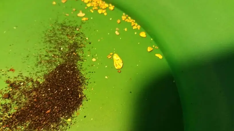

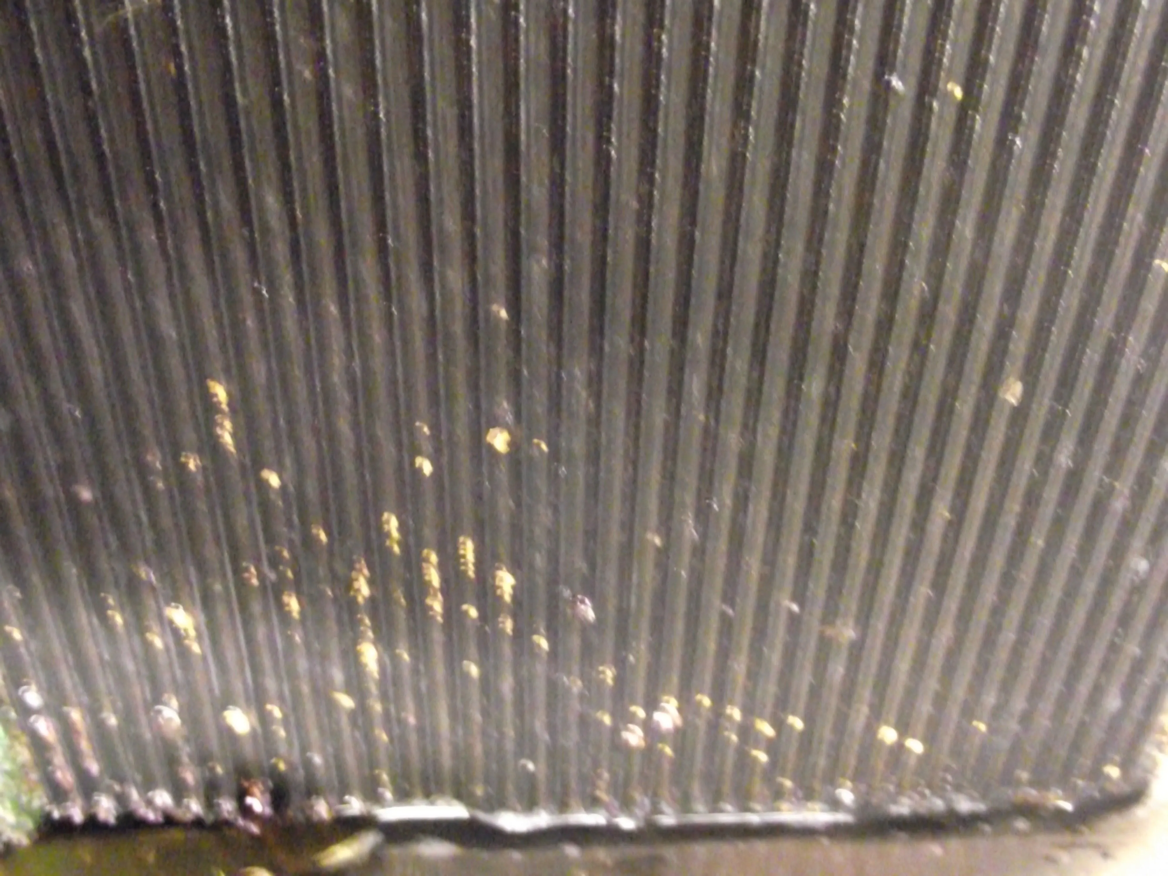

The fines are in the box.

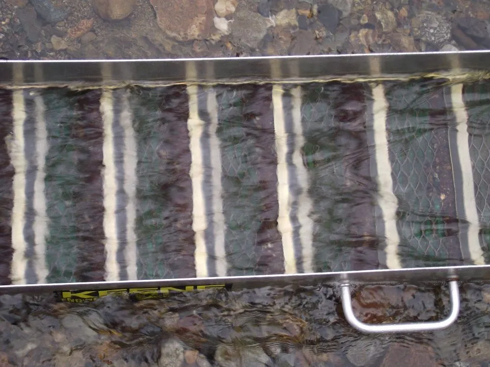

As for classifying my dirt. I classify when I am running my Keene A51. But I dont classify while Im running my CalSluice.

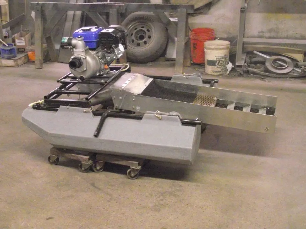

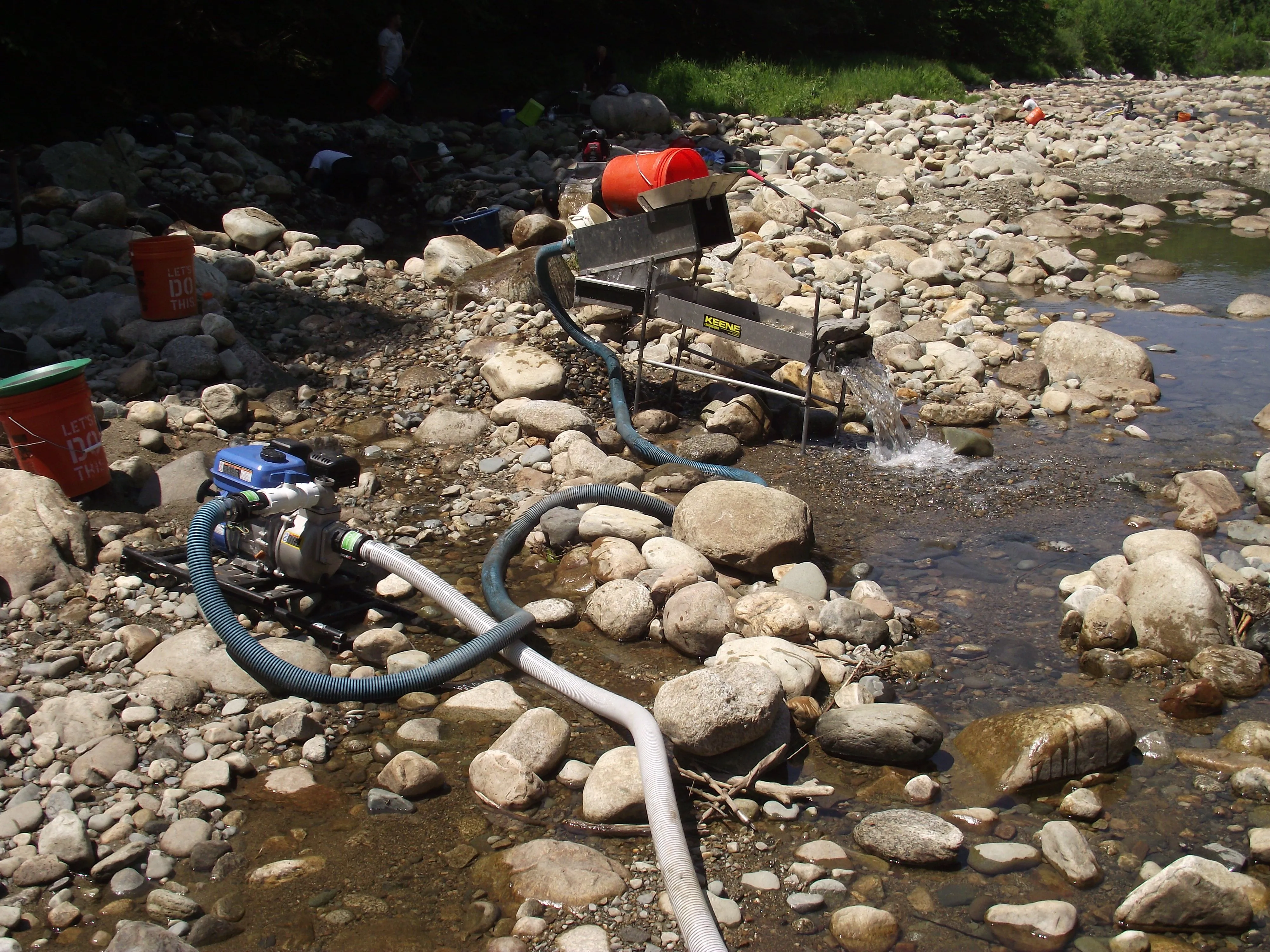

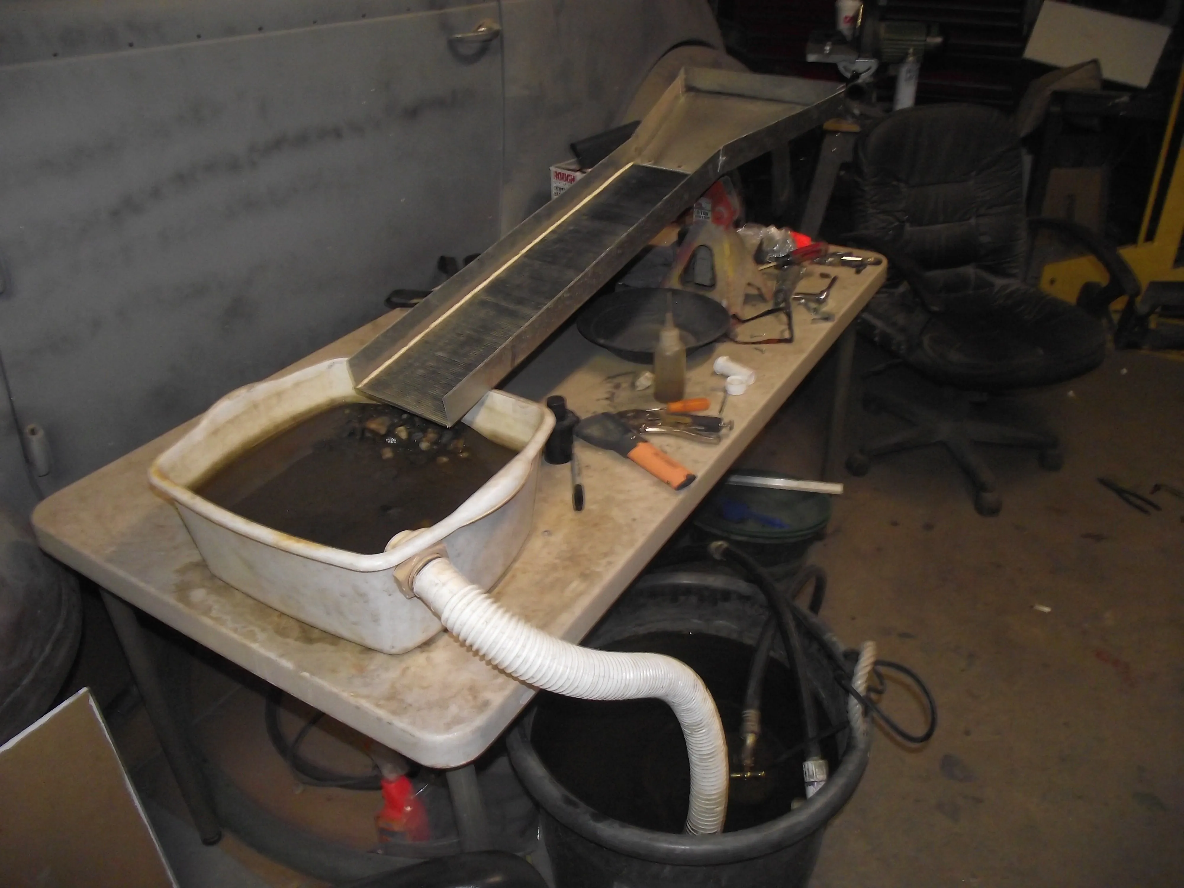

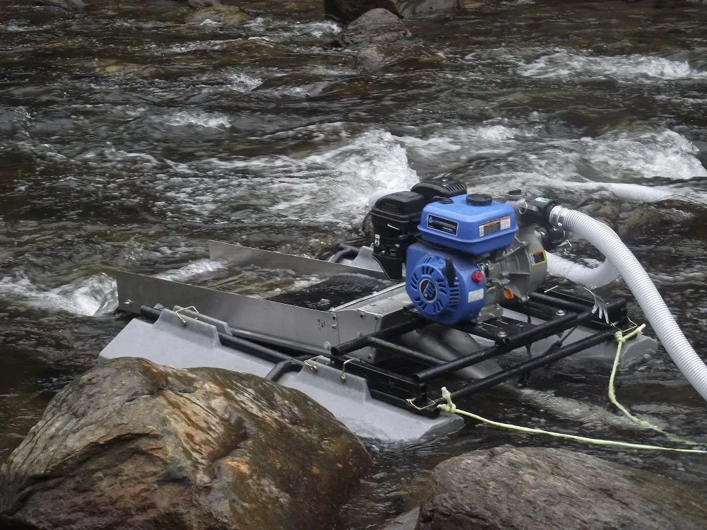

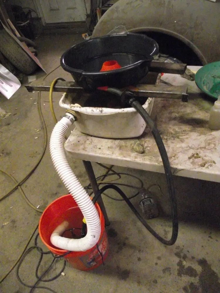

The only thing I have bought is a sluice. I build all of my own equipment! Yes some times a manufactured piece is better than homemade they did the research, testing, just ask Gold hog. And I didn't try to con you into digging dirt for me! I split everything that comes out of the ground! Here's some pics of my stuff just so you know! Notice the lack of muck and clay in my sluice DSCF0445.webp

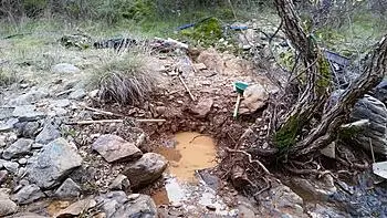

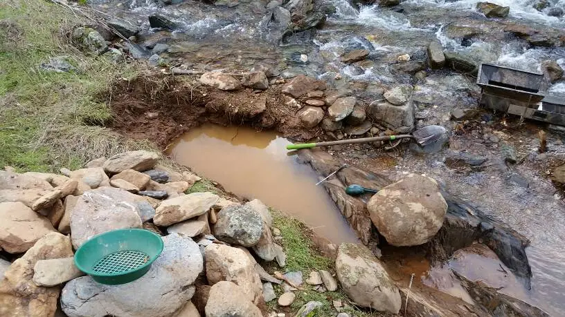

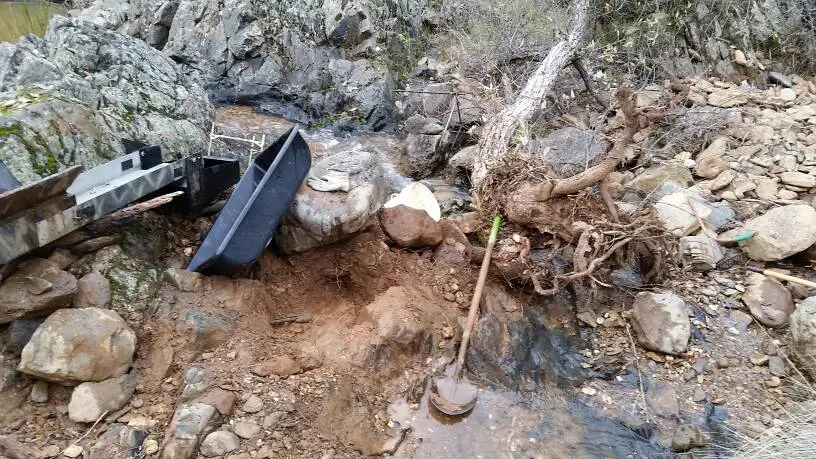

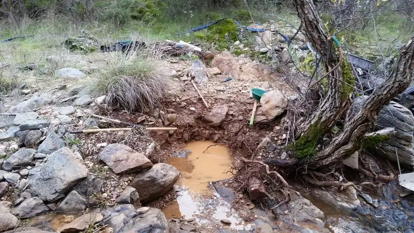

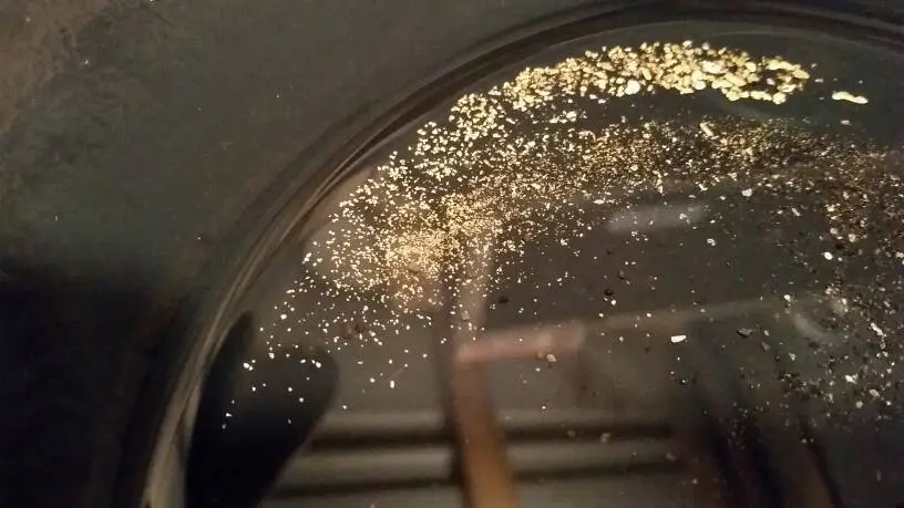

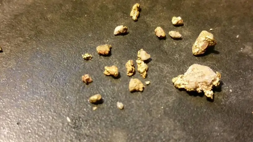

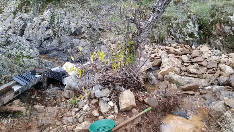

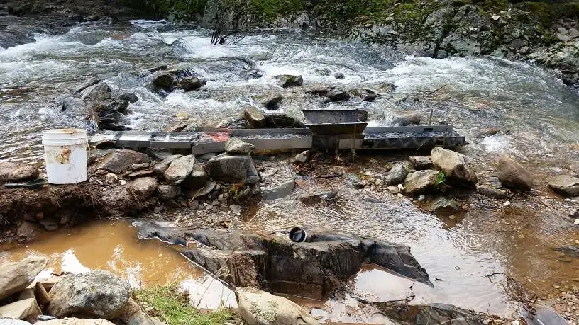

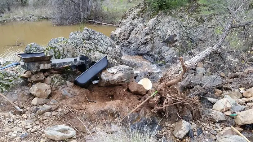

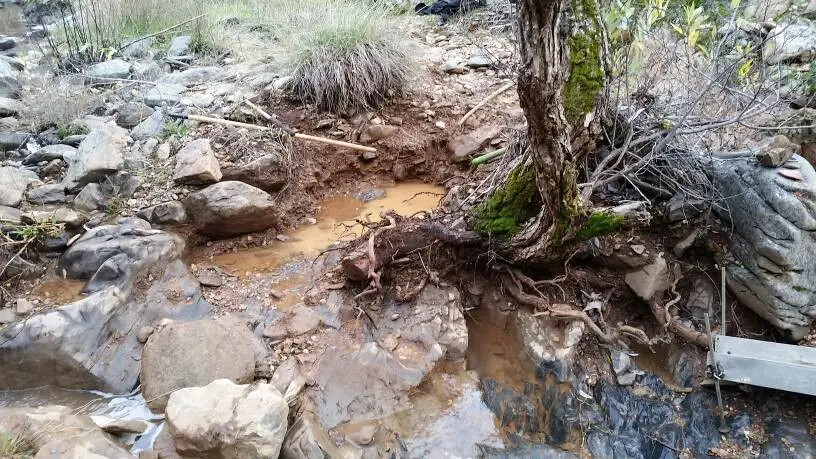

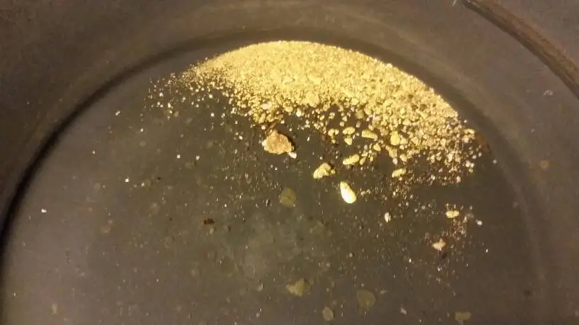

The proof is in the pudding and your pudding sure looks good to me! :notworthy:
Wish I had ground like that to work here in Indiana.
I would trade a few lost fines for cleanups like that any day.
Don't get the idea that I spend much time getting my bank run material ready to run because I don't.
And by the way are you allowed to discharge your bank run material into the stream like that? Not that it bothers me any, it's common practice in my neck of the woods but I thought Kali had strict rules about that. What is the currant rule I'm not sure? :icon_scratch:
Like your DIY dredge, bowl, and shovel. Well done :icon_thumleft:

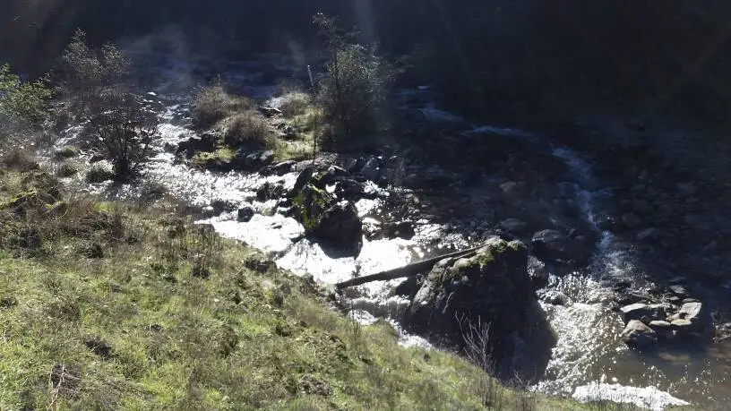

Having a year that you take so many pictures of the High water line. and document it:headbang:
In stream work. thats all it is.
This years water has moved the majority of what you see there plus a whole heck of a lot more . Its pretty awesome.
