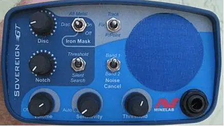

Fletch is 100% right. I however think the ATP sucks as it is to touchy in regards to EMI. I am on my 3rd ATP and it night just be cell phone tower's. Others seem to like them and I wonder if I am to picky. Another excellent choice for land and wet saltwater sand is the Sov GT, the land version of the Excal and you can change coils. Many consider it the best beach unit and its only draw back is you can't get the box wet.

I wanted to plug the Sovereign but figured everyone's tired of my raving on the GT!
Can't beat the one two punch combo of a Sov GT and Sand Shark. Both are VERY reliable machines, you have your choice of both VLF and PI technology, and you always have a backup machine incase there's a need to send one in for mods/repairs. Both can be purchased for less than $2k. Just another opinion...
So really, if I get a Sovereign GT, I wouldn't really need any other detector since it will work in the wet sand and everywhere else, until I drop the box in the water(I am very careful so unlikely to happen). This seems too good to be true but apparently not.. I just checked it's depth and the Sov GT has incredible depth. With the discrimination on this detector as well as it's depth, I don't see a need for a PI detector in the wet beach sand anymore. The reviews look fantastic on it. When I am on land I want to find everything from coins/jewelry to relics, if it can pick up gold nuggets too than it is perfect.

I think I might go with a Sov GT and hip mount as well as waterproof the box. I like the depth over all other MF detectors that I have researched and it seems it would do great at everything from wet beach to really any other condition. I like that I can change the coil and it seems to be able to detect pretty much everything just fine. For my purposes, I don't see a better detector. If anyone thinks there is a better match for me please let me know, otherwise I think I may pull the trigger!
