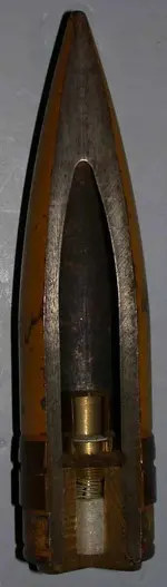

If you really think that is an artillery warhead, then get it out of your house and call the bomb squad. I was an artilleryman in the Army, and there is NO reason for a "solid" projectile. However, I'm still in my underwear AND drinking beer.

The ones of those with chemical innards are especially tasty :D
But you keep going on about wearing underwear . Prolly everyone here has you pegged for a nudist typoist. So we need photographic evidence :D

There are plenty of solid shot artillery projectiles. they rely on kinetic energy rather than explosives. 37mm AT rounds for example, and modern Sabot Penetrators, also most practice rounds are solid shot, I had a 155mm solid shell as a door stop for a long time....

Not going to argue since the round is obviously not a, "modern Sabot Penetrator." Common sense rules in these situations. :occasion14:
