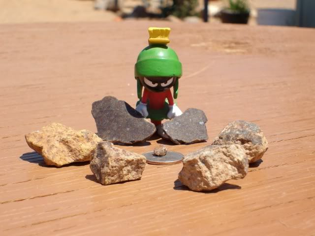

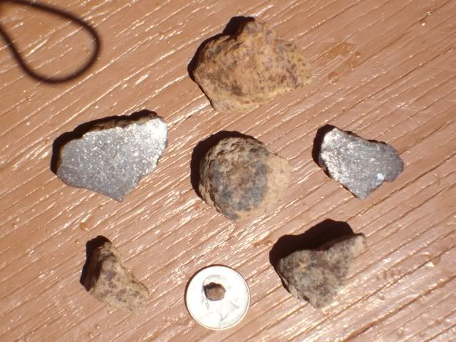

The first two pic's seem a little sketchy (in my opinion) in regards to it being a meteorite... but those last two?! Yeah, it looks like one. It'll likely take an expert to really tell the difference I suppose.
Bran <><
