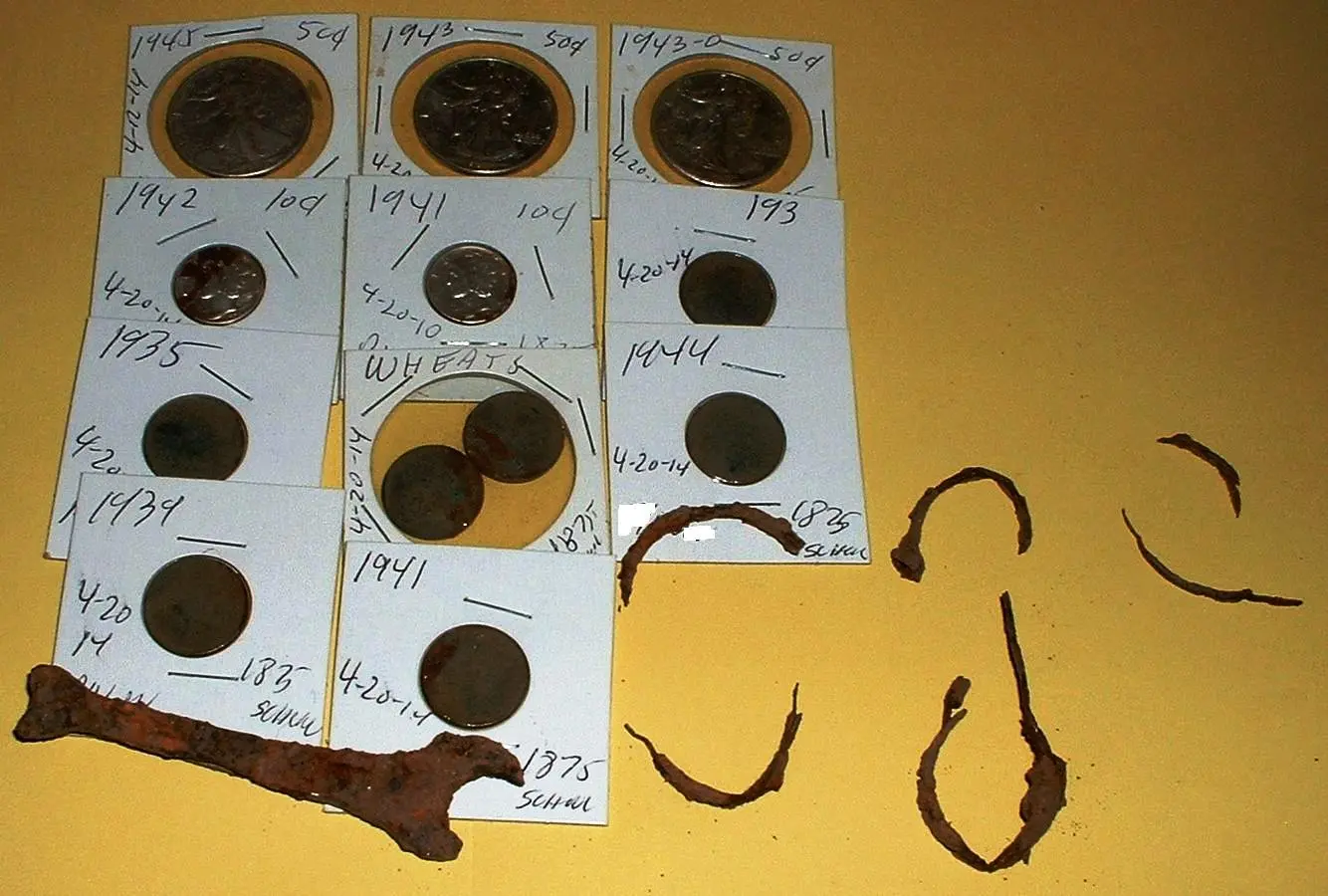

And YES Like a detetor will try to detet each Link on a Chain Seperately.
If there is a pile of coins togther, The detector Will Try to Detect each one, So your gonna get a Crappy signal that you may not be able to Pinpoint, All you can do is Dig Crappy Signals to find out if a Bunch of
Trash or coins . or Move away and try to Sneak in from the edge in hopes you can find them Seperately. A mason Jar would Most Likely be easy because if the Lid , If Buried Upright ,
I Honestly Think if a Pot was filled with coins, Unless it has a Lid,
Will most likely Give a Crappy signal with the coin, or Edge or the Pot closest to the coil Trying to let the detector snag it, and the rest Interfearing. :dontknow:
Thats One of those Unknowns Till You detect & Dig One :dontknow:
The Small cache I found wasn't Deep But took 2 days to Seperate & Dig each Coin because of the Tin Bits & Rusty Ground from the Tobacco Tin & the Wrench
