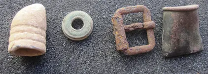

where does the cartridge come from, the buckle and also what that round object is? I can only send 5 photos per message so I will add the rest now. Thanks in advance.

Welcome to Tnet. You don't have a cartridge you have bullets. The round ones are bullets also. We can guess but you need an accurate diameter. Good stuff!! Did you find them?
It will help us if you can provide accurate measurements of diameter and length. A digital caliper costs about $20.00 at almost any auto parts store and is a great tool for relics. And a picture of the shell casing base with measurements will also help us. That being said your round item is a tent or tarp grommet, the first bullet, without precise measurements may be a Starr carbine but that is just a guess.Tthe second bullet is a 3 ringer, most likely a Gardener, that is either a .54 or .58 caliber. The two groove bullet is a Confederate Gardener patent and it came in .54, .58 and .69 calibers.
The round thing is a poncho grommet.
Your flattened casing is probably a Spencer

Your first bullet is still too dirty for certainty in identifying it. As my friend Fyrffytr1 guessed, it might be a (yankee) Starr Carbine bullet. But it seems to have a wide groove above its base, which would make it a (yankee) Smith Carbine bullet. See the photos below.
As he also indicated, buying a $20 digital caliper is essential if you want to figure out the correct ID of the bullets (and coins) you find. A Starr Carbine is .54-caliber, and its unfired bullet typically measures about .552-inch. A Smith Carbine is .50-caliber, and its bullet is typically about .524-inch. Thus, you see how important the caliper is, to detect the .03-inch difference between those similar-looking bullets.
Your second bullet is a "generic" 3-groove Minie-bullet which has been fired. The fact that its base- cavity is off-center is often (but not always) an indication of Confederate manufacture. Is the base cavity's shape a pointed cone, or a parabola, or something else?
The third bullet is a (strictly CS-made) Gardner's Patent Minie-bullet, which is in unfired condition. It appears to be the .58-caliber version, but precise measurement with the caliper is needed for confirmation.
I agree with Smokey... the round flat brass object is a grommet, most likely from a soldier's poncho.
The "round object" appears to be made of lead. The ruler (thanks for including it in the photos) shows it is a bit larger than 1-inch in diameter. So, it is definitely not a bullet. If it came from a civil war battle site, it is a Canister-ammo ball.
Th small-ish iron buckle could be from many pieces of horse equipment, or soldier's equipment. No way to know for sure.
About the brass cartridge-casing:
As Fyrffytr1 said, we need a closeup photo of its base, and precise measurements. Meanwhile... the most common one which is "about" the size of yours is a .52 Spencer Rifle/Carbine bullet's casing.
