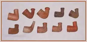

I find a lot of stuff like this myself watcha think this is ??
It has a seam in it ....it was in a mold.
That's the stem section of a colonial elbow style pipe. A large producer of those was in Ohio. That pipe could be from the late 1800's to the early 1900's. A Reed would be inserted into the opening.
i found that on an adena site ...stepped on a blacksnake that day and found a 1921 penny there real close to the pipe section...was a fun day... i cant remember if i found any arrowheads that day :icon_scratch:
oh so your also an expert on historical ohio ....you never cease to amaze me gatorboy....:laughing7:
