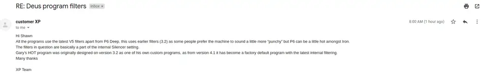

Well, it's official! Just got an email back from XP. They said the Deep program was the only one still using older filters, although they say it is based on V3.2 filters. All other factory presets were updated with the newest filters since V4.1. To the OP, don't let this change your mind because as me and Vferrari were discussing, this only changes the way the silencer software filters the audio.
Thanks for running that to ground, 67. Yeah, as I said above, from a filter/signal standpoint, I thought v4 and v5 really only addressed new hardware compatibility and some added features like tracking ground balance sensitivity adjustments and the way silencer automatically adjust to reactivity settings. So its not surprising the filter settings stayed the same as v3.2.
