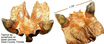

Looks like a tapir incisor and some deer teeth in a piece of jaw? Ok, horse incisor sounds good also. Harry , did you make the show today? 8) 8) 8) :)
It could be tapir, William; but, tapir canines are "blocky" while horse canines have blade-like carinae. I thought I saw bladelike carinae on this tooth.

tapircanines.webp​
