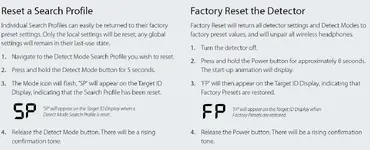

Problem is that a complete reset will require going through re-pairing of the wireless bluetooth headphones if you are using these. Alternately you could just reset the individual 'detecting mode' i.e. Field 1 or Park 2 etc. The difference between the modes from my understanding is predicated on the 'weighting' of which group of frequencies are transmitted and how they are processed by the electronics, etc.
