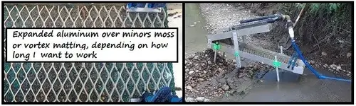

This is what I currently use. (below)
John, If I may ask, what type of expanded is in the upper section and is that ribbed mat under the mesh? Thanks.
John is a little tied up with the Redding Cal. fire. but he has unbacked Veranda carpet in the sluice and it is made by Shaw carpet.
