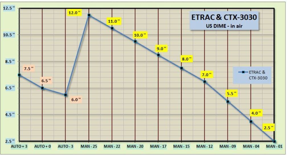

The chart above was created in an area where EMI was problematic but I still could repeatedly ascertain a clean audio with a diggable signal on a dime at 7.5" in Auto+3. With Manual at 25 you're around 12" on a dime. That's with the standard 11" coil. Same figures for the CTX and E-Trac.
