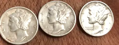

Just getting used to my new ctx-loving it! 676A3D09-6B44-4EDB-B633-8C357AE17237.webpDC9908CD-0E7A-4780-A5DB-FD5C1E838212.webp5AD617CF-1FF3-41EF-A397-E57B948A6B0E.webp
