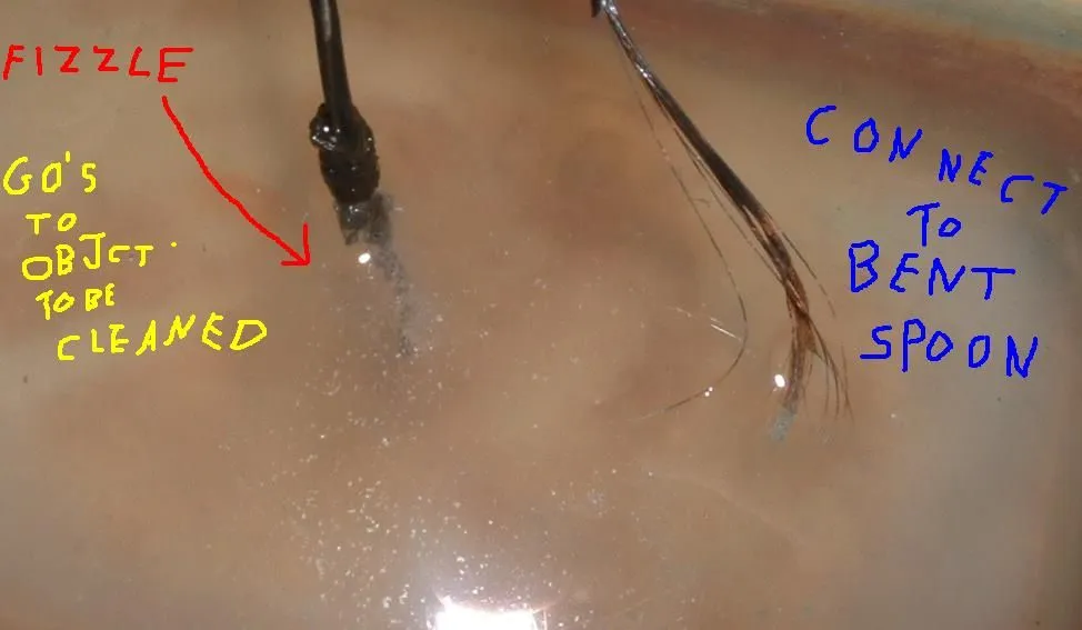

realy all you need is a cell phone charger,
a Stainless Spoon
an Aligator Clip
& A glass or Plastic Bowl.
& Salt, Baking Powder or Baking soda
Salt is the most Abrasive. But I Like it.
Hook the object to be cleaned
to the wire that Fizzles and
the spoon to the other.
when you place both
in the mixture & The object to
be cleaned in the alligator clip connected to
the other wire.
Use larger charger, Stainless conductor & Bucket for larger items.
WARNING !

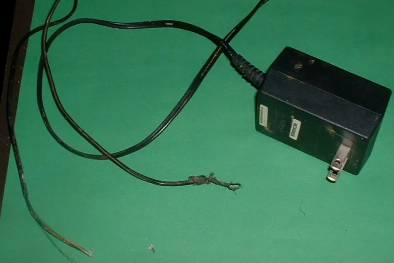

Don't let wires touch each other. Only takes 2 Seconds to Burn Unit out.

Yep Like boogeyman says & what I Was trying to say with
Use larger charger, Stainless conductor :tongue3:
I Once cleaned up some Iron
Stove Plates.
They were so Heavily rusted it took Days,
& The drag on small Charger made the Plug
get very Hot.
the plastic was hot enough to burn me
when I Unplugged it.
Burned out several of them to do it.
A motorcycle battery charger & heavier
strips of stainless should
have been used for these.
