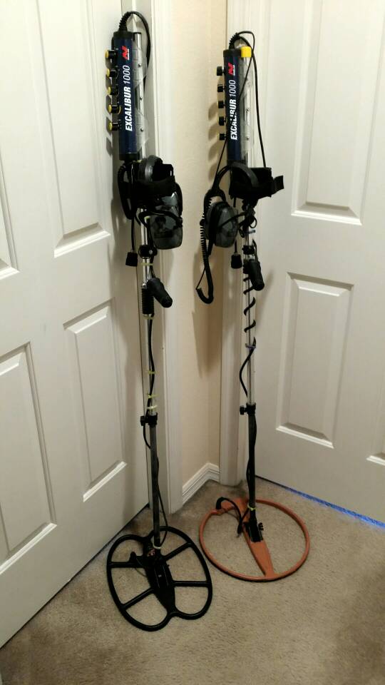

Im assuming they arent CF, or dont have cuffs or bike handles....... what you swinging for $25? I dont travel enough to have a 3 piece....... and half the time cant get the darn lower shaft off anyway. BUT i have to say CF comes off a LOT better than in aluminum. I also like what Chuck done by putting a cap over the top of the lower shaft so you can insert a rod and tap it out easier.
I recommend anyone purchasing a Excal for the first time to learn it with the stock coil before going to any other size. For me the stock 10 inch works the best and I have many options on sizes to use.
No not CF, aluminum, used cuff off original handle and bought 2 bicycle handles for $10, the 6' deck handles were $20 each and are triple-anodized, heat-treated aluminum...
