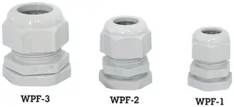

Newmar makes some nice marine grade penetrations they usually have a slotted rubber block that compresses when you tighten the gland nut . I would check it out because they make marine power supplies and cannot afford leaks.
