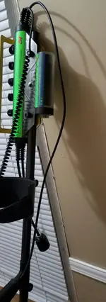

Well I finally did it.! Picked up this excalibur off eBay for a reasonable price, considering it has all the mods I was wanting. Everything came as advertised and the machine seems to work fine. But.. the wire for the PP is to short, so from where it comes out of the back of housing it makes too tight of a bend and has caused a split... The guy I bought it says mods were done by KellyCo. Which he sent the invoice that shows everything but the PP it's self. But it did come with PP installation instructions... Anyway I guess what I'm asking is should I send it back to KellyCo or is there something I can do? Or is there someone on here that does this kind of work..? I'm just ready to get in the water but not at the cost of my machine! Thanks for any advice

Does not look good. Do you have a picture of the handle and switch. If it is one of my kits I will fix it for free...but you will have to disconnect all and send the handle and endcap. I did several kits with the double heyco's a few years ago. Now I do the m12 connectors just for this reason so if anything goes wrong you can unscrew the connector and I can do another to swap out.

Let me know if you need more pics

Your welcome, and that is a Kellyco switch, the Cherry KCA. I try and take care of all I've done over the last three years. On what you have there you would need to take the endcap off, the handle and head phones in one unit and send. Now the other thing I won't be doing any work until Jan 1, then to March 1, and only on PP kits and endcaps. No installs or repairs done to any machines. I find it much easier to do kits and a limited amount since I love hunting for treasure more. And I cover my kits for three years use if you do decide to go that route. Sending you a pm on the price since I don't think I'm allowed to post that..

I wouldn't use tape either....even Rescue tape, which I like very much for other waterproofing projects. RTV is a liquid sealer used extensively in the automotive industry. It dries to a nice flexible rubber consistency. Just make sure you clean the cable completely around the cut. Use alcohol or acetone. This is just a temporary fix to use while running the Excal through it's paces. You want to make sure there are no other problems before going to the trouble of sending it in for repairs. If water got inside the cable, it could migrate down inside the control pod, so, you would want to do a proper repair for continued water use.
That cable looks funky for some reason to me.
Low grade... AKA... not correct IMO.

There looks like there is enough slack in the cable in your picture, previous owner may have rearranged the cable and taken out the slack. I talked to Dave at kellyco, he said if you send it in to Kellyco, he will fix it for 1 hour labor. ($75) If you don't want to send it in you can fix it by spraying it with plasti-dip, about 4 coats.
