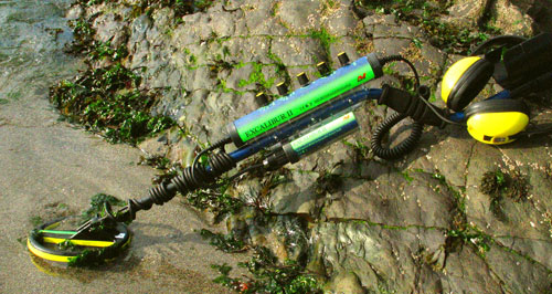

Hi all!
Many of us are/have been users of Minelab Excalibur detectors. Many mods have been created to enhance the way we can detect with those great machines but I haven't found a single place where I could found them...
- Shafts, carbon fiber, short, long, over under, scuba
- Remote PP, with or no light, toggle switch, push button
- Battery enhancement, use of LIPO 4S elements
- Headphone replacement and upgrade, use of Bone Phones
- Coil replacement and connectivity on Excalibur
- Body replacement
- Buttons, knob guard
- Hip mounts
- Power and sensibility enhancements, boosters
Please post pictures of your personal mods or mods you're Fan of!
I know OBN could make this thread live forever :notworthy:
