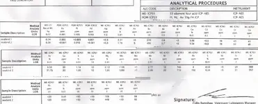

i have this vein of blue clay sandwiched in a hard pann layer.
i took some of the bottom layer where it is rusted and panned it.
i got pieces of lead, i sent in a sample and got .o12 ppm of platinum and 102 ppm of lead.
this is a picture of the lead i found . it measures about 1mm.
if i find this lead what are the chances there is gold as well.???

this has to be native lead, it was found 15 feet down under the hard pann on a 20 year old road cut. there is no way lead shot could get there ,

An assay is only as good as the sample. Cherry picking a sample is usually not a good practice especially in a sedimentary deposit such as you have there. If the sample does not represent a good cross section of all of the varying material in that cut bank then you still do not know what all is there and what the proportions of the different elements are. The best way to check a possible gold placer deposit is to test pan it to see if it contains gold.
Good luck.
PS: It would help a lot if you let us know the general area where you found this.

I am located on vancover island, i did the assay to see if what i indeed found was native lead. Turned i was right, as for panning, i will do that, i had gone up the hill to a old mine and found the same clay vein. i had found golf there years ago but thought i had to get to the bedrock to find the gold. Starting to think i may find it under the clay vein.

FYI - Native lead (elemental not galena or other lead ores) is very rare. If you find some good specimens there may be a market for them by mineral collectors.

I too would focus my samples on material under the clay layer since it is apparently highly mineralized.

Do not waste your time and money on highgraded samples. You can't adulterate the samples for analysis in any form for true results for economic viability-John
hi john :occasion14:
i do not see this as a highgraded sample , we where mining the clay layer for cosmetic clay and noticed the layer under it. i panned a bucket and got some lead looking pieces, i wanted to see if it was lead and wanted to see what else was there . i took a 1 pound sample of the layer and put in a peice of the lead in the sample. So other then the lead result it is a fair test.
