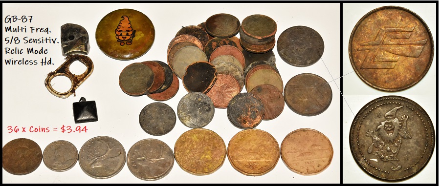

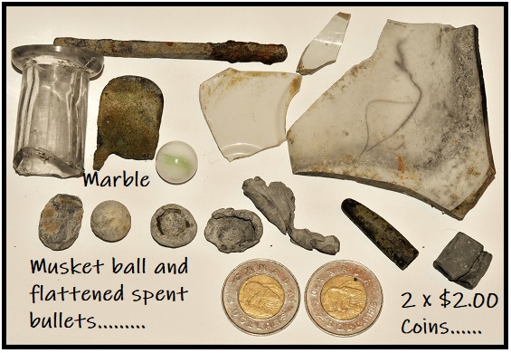

I hunted an old river boat crossing yesterday. I specifically chose this site, as there is a lot of hot rocks and black sands too. I hunted in multi-frequency setting, and ran the APEX at 5/8 sensitivity. Any higher sensitivity, it became too unstable, due to the multiple ferrous objects in the gravel and water. I was using the wireless headset, and it performed well, even with the coil in about a foot of water. The new 6” x 11” DD Viper search coil designed specifically for the APEX will not work on any other ACE detector. It covers a lot of area per swing, yet is very sensitive to tiny conductive targets. I remember getting a high tone on a target, and when I finally found it, was about 1/8" x 1/8" buried at about 3-4 inches. The hunt lasted about 5 hours, with absolutely no fatigue from swinging the APEX. The separation between targets was very clear audibly. I had to hunt with the iron audio set very faint, otherwise I was going to suffer burn-out.
I really like the ID capability of the APEX. It really locks on well on a target, both with VDI numbers and audio. A very enjoyable machine to use. I haven't really tested it's depth capabilities, as I was more concerned with getting comfortable with this machine. But, so far, the ID capabilities are excellent. If you have an AT Pro, the audio is very similar, or perhaps even better with the ability to adjust the iron audio. Also you have more tones to utilize. Just for interest sake, the lead targets all came in at about 65 +/- a few numbers. Heck, I even found a couple of modern two dollar coins together. They read in the 80's, a definite target I would dig.
As I familiarize myself with the APEX, I will continue to get out information. I still need to figure out how it reads Canadian coins and how deep it can go.
Hunt #2 Today, After it stopped raining
Hunted for coins at a park for a couple of hours this afternoon. I need some practice to pin-point targets. After many attempts of trial & error, I came to the conclusion that if I lift the coil about 5-6" holding the pinpoint button, the search area is much smaller and much more accurate. Or, you can de-tune the coil, which also creates a smaller area to pinpoint.
Now, I am really liking the ability of the APEX to ID numbers. In my instance, I have copper pennies, steel pennies, zinc coated pennies and memorial cents to contend with. The APEX consistently reads the different types with different VDI numbers. The proportional audio (deeper targets are quieter) allows the user to pick out the deep targets without looking at the screen. A headset of some sort is a "must." After hunting with the APEX for an hour, I thought that I was hunting with my AT Pro. The AT Pro is probably the best machine available to ID Canadian Coinage. If you have the AT Pro, you will love the APEX.
After hunting for about 7 hours, I was down 2 battery bars. In other words, this machine carry's a charge for a long time. Looking forward to some more hunts next week. Hoping some other people will soon start posting as the machines get sent out.
