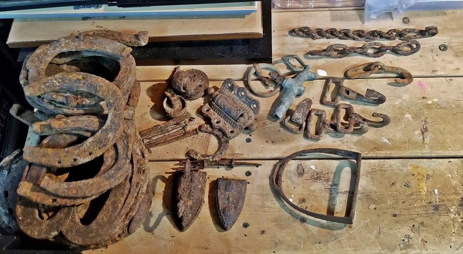

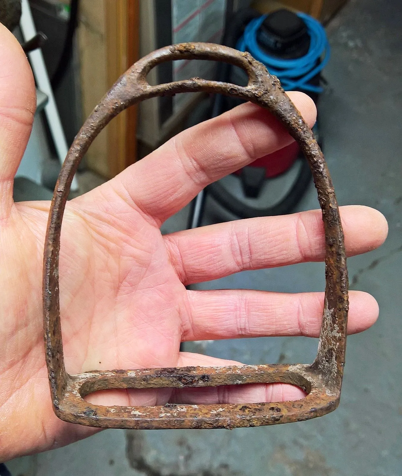

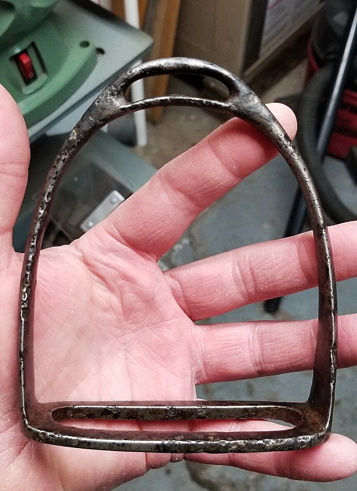

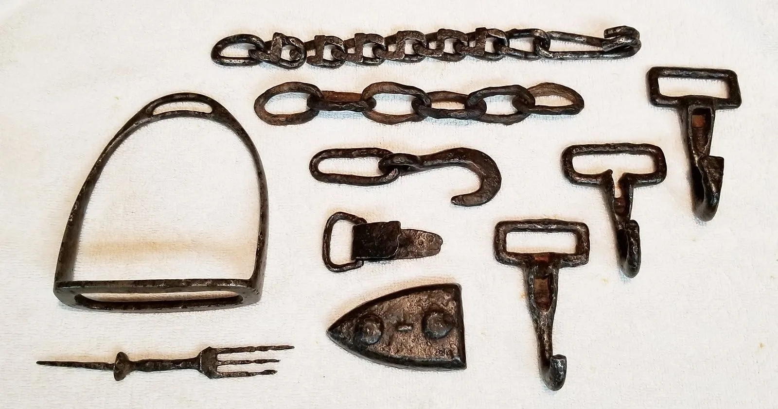

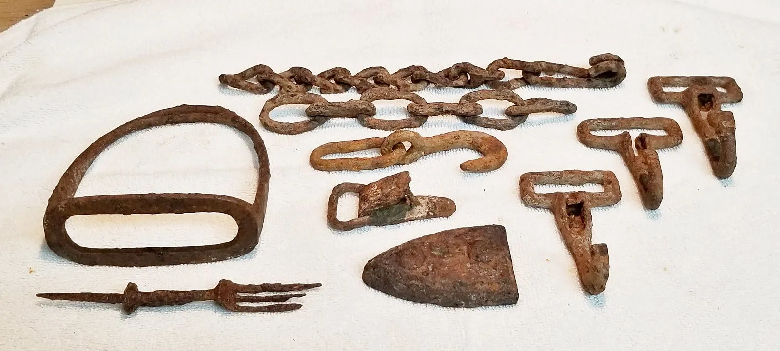

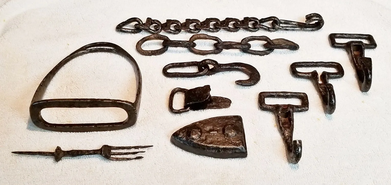

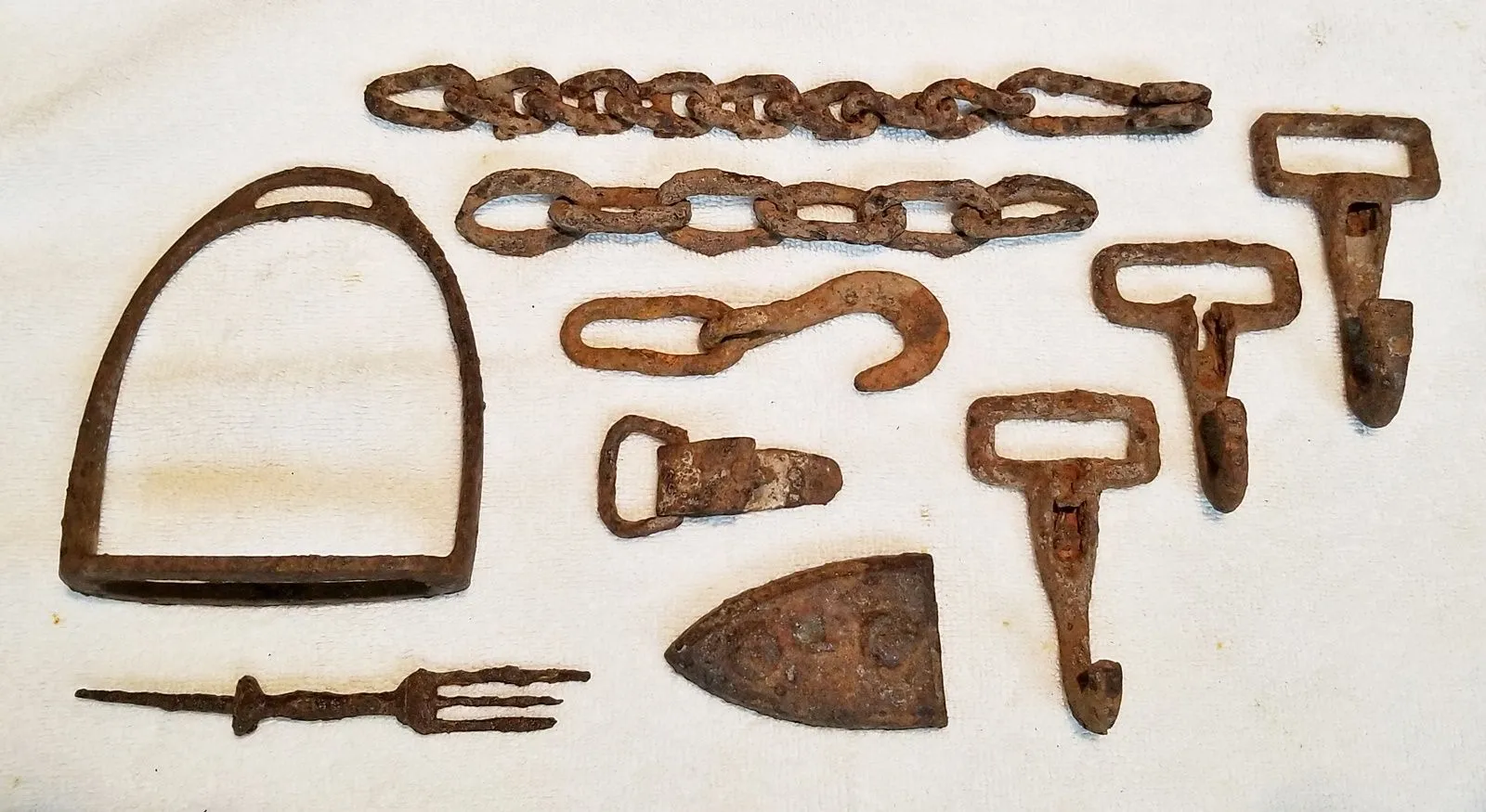

Last Sunday I started tumbling my ferrous iron finds, being unable to detect due to the snowfall. I use a Loretone 45c tumbler for my larger relics. I start with ½ - ¾” polished gravel, a 1/3 of a cup of beach sand, a tablespoon of liquid dish soap and hot water to remove the surface rust. I tumble for 24hrs, drain and rinse the mixture and the finds in a large colander, I then repeat once more for another 24hrs using the same recipe. In the last part of the process I tumble for another 24hrs but minus the beach sand, this helps the clean and polish the iron. I then thoroughly rinse everything letting it completely dry for another 24hrs. I then apply a liberal coating of mineral oil and beeswax paste to seal and even out the finish.

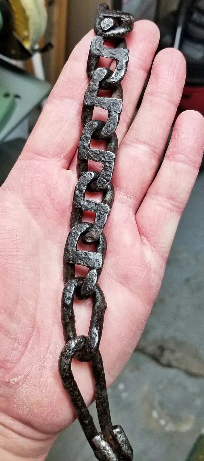

I'm also showing a picture of an unusual looking chain, I've never seen links welded like these before. :icon_scratch:
I'd be interested in hearing your thoughts on it's age or original use.

Awesome how they appear now! The mystery chain is from a set of tire chains.
Thanks very much for your post and for identifying the 'mystery chain' Kray. :thumbsup:
Tire chains are legal for use here on construction equipment being used on winter logging roads in Northern Ontario. In 1972 the Province of Ontario, after a technical review, determined that tire studs being used at the time were causing extensive road damage. In 2005, the province modified the law to allow studs in Northern Ontario regions between October and April, similar to Manitoba and Quebec.

Great looking iron relics. I especially like the iron stirrup and the old fork. Have you ever watched any videos on Gemplers, the product used for treating iron? I used it on my relic artillery shell fragments and my Confetrit 12 pound shell as well as other iron relics. I was pleased with the results. It will turn the iron black, but it preserves the iron leaving it with a nice finish. I always like to state that I'm not a salesman or in any way affiliated with this company, just a satisfied customer. Gemplers, check it out and see what you think.

Hey Dave , what are the hook looking things? I found a very old one under a root ball from a very large old blow down. The hole it left was 5’ deep and the hook was dead center at the bottom. Good looking stuff. For what it’s worth, I hate snow!!!!!!
They are snap hooks.....most often associated with horse tack. Wow, yours was deep in the hole.
Hi Bob, I see villagenut already identified the horse harness hooks for you. :thumbsup:
These are very common finds on farm sites, the fact that your was so deep is surprising, it must be very old.
Dave
Exactly, you beat me to the I.D. :angel3:
I've often tried to think of how these harness hooks can be repurposed, as they clean up so nicely.

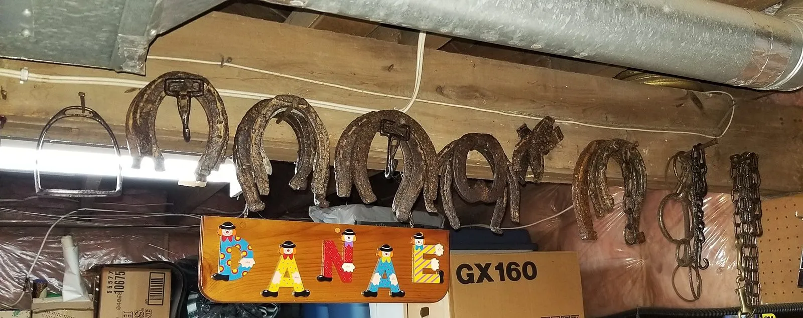

The only problem now is... my basement workshop looks like a Victorian Period slaughterhouse with all of the hooks and chains hanging from the joists. :laughing7:
