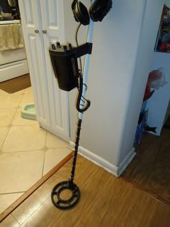

I opted to use clear plastic tubing and run the original wires up thru the tubing. I removed the coil wire nut and siliconed real well under the nut to ensure that no moisture will seep into the coil. (I hope!) I will make my soldered connections by the control box, about 8" out of the box, and seal as I did on the coil. Just got finished sealing the coil end and should be dry in about three or four hours. Gonna take some pics today and post later for those interested. As second insureance I think I might try some of that "FlexSeal" on both ends. Looks like it's gonna work pretty good!
Re: Fisher CZ-21 Coil Cable Repair. Help!! (NOW W/PICS)
Finished except for FlexSealing the two ends. Detector works purrrrfect!
