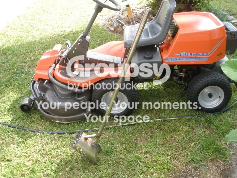

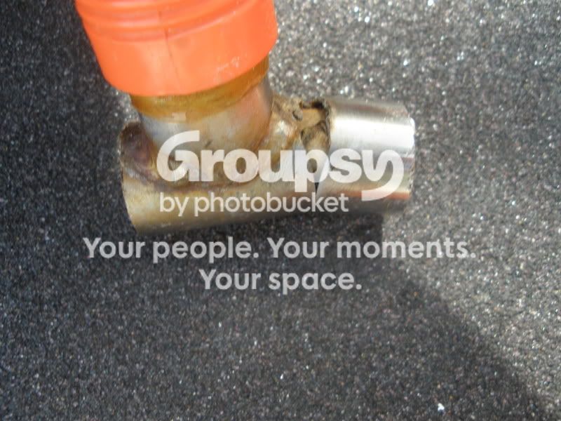

I have an RTG Royal that was cracking where the handle attaches to the basket... so I welded that back a few months ago. Then a week or 2 ago while in the water, I drove it in, and pulled back and the handle simply ripped at the weld for the lower handle. What a pisser, less than a year old >:(.
So I cut it down to the handle, went to Alro metals and picked up a piece of SS big enough to slip over the old handle... fit like a glove. Welded a bead around the bottom of the handle, and a lil more gusset welds where the handle attaches to the basket.
