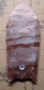

Well now I know why you’re so good with regional material identification... Do you still have the Folsom made from #5?

Yes, I do. It's in a frame. I'll get it out and get a pic of it today. Gary
Here you go Kantuck. The point is 2 1/8". I forgot the scale. I made this in the 90's. Material is Alibates from Texas Panhandle. The color is most correct in the pic with it in my hand. Gary

Thank you Gary. That's beautiful! I can't wait to see some of your others...
