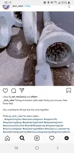

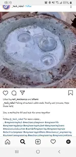

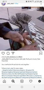

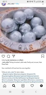

I just came across a video that show these same sized ingots in zinc to solder/swedge cables. Not saying that's what they are, but they look very similar and I think they used silver solder way back...
Screenshot_20200519-081354_Instagram.webpScreenshot_20200519-081355_Instagram.webpScreenshot_20200519-081331_Instagram.webpScreenshot_20200519-081338_Instagram.webp
i was gonna say maybe some kind of solder composition
