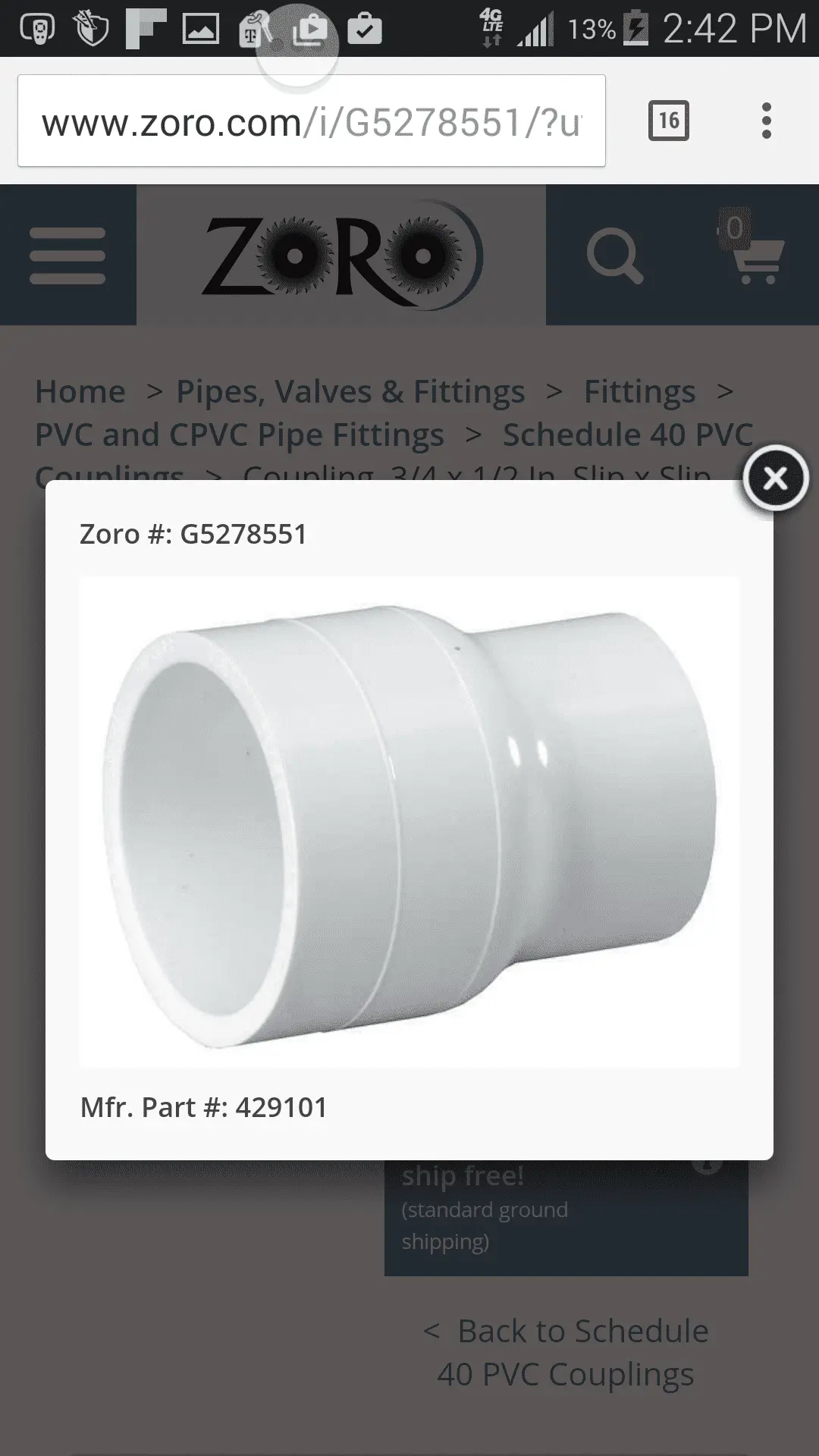

That's what I've been afraid of. I was thinking about just putting a small bell reduce on the end of my pipes
just to increase the pressure slightly but not over power it.

Just to say , if you use funnels or 2inch pipe , or 5 inch pipe ..... It will NOT make the pressure bigger :) it just dont work like that :)
Add a bell reducer to the pipes. where the water goes in. the water hitting this will cause an increase in water pressure in the pipe. it makes a venturi action
