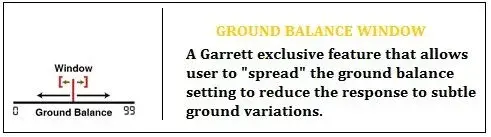

Don't forget to use your ground balance range adjust, a great feature on the Garrett Gold.
