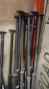

All water utilities already own probes , they use them to locate the pipes they are digging up and to help find lids , manholes and such. you can buy probes most anywhere that sells plumbing supplies, even lowes and home depot have them
