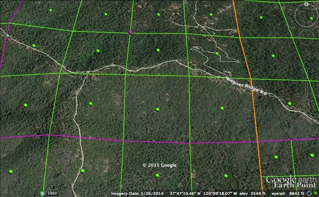

Here is a sample of a random area out in gold country. The purple is township and range and the green is section. It is clickable.

Good lord! Those people are charging for the old PLSS?
It's free to all at MetzgarWillard. Download the free kml. There is some other FREE cool stuff there too so look around.
Click the free downloaded kml/kmz and start up Google Earth. You will see the Meridians, Townships, Ranges, Sections and quarter quarter Sections all the time for free.
It's not accurate, it's not current and with Google Earth it's not in the right spot but it's the same as what Earth Point is charging for. :BangHead:
This is public information. It's available for everyone in a bunch of different formats and it's no longer used by the BLM, Forest Service, any government agency or Land Matters. It's been replaced and "upgraded" to the theoretically more accurate CAD NSDI several years ago.
