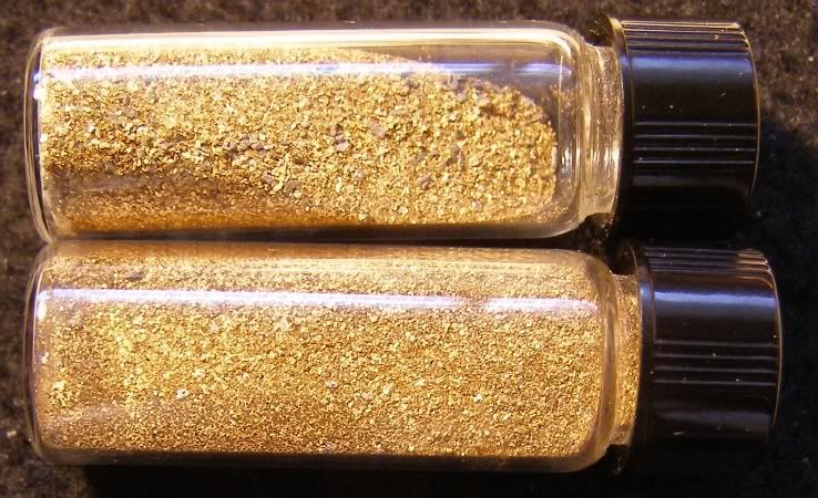

I have used the Gold Stinger for about a year now, and dug thousands of targets with it. I don't have any nuggets in my immediate neck of the woods, so I only used the stinger to find the higher concentrations of black sand in the gold producing river through Edmonton, and that's where I panned for the flour gold. (the pic below is from many years ago of the flour gold I got in Edmonton, before I was metal detecting.)
