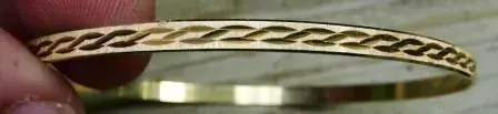

I have several items marked Gold Filled that I found while detecting over the past few years. The pawn shop told me it's not worth anything. Is this true? Is my gold filled jewelry worthless?
What do I do with it if it's worthless? Thanks for the help.

If red is right, and she usually is!!! It is not actually "filled" Just a heavier gold Plate!!! Chug sorry High class costume jewellery
If your jewelry has the all of the information needed to determine how much gold is on it, then it is not worthless. The first thing you would expect to see is a fraction. 1/20, or 1/10 are the most common. Next you should see a purity: 10K, 12k etc. Then you'll see the GF indication.
Here's an easy example calculation . . .
You have an object that weighs 20g marked 1/10 12K GF.
One tenth of 20g is 2g, so you have 2g of 12K gold. It just so happens that 12K = 50% gold. 50% of 2g = 1g. So you have 1 gram of pure gold. On the day I write this, gold is valued at almost $44 per gram.
If you have a reasonably large quantity of gold filled items, or if you can put some "karat gold" with it, ARA will give you 98% of the spot price. A "large quantity of GF" might be 500 grams. I've never sent GF only, but mixed up some solid gold with it. It ups their turn-around time from 3 days to 7, but it takes 7 days for silver anyway (but bag and mark silver separately, it is processed in a separate batch).
For more info, read CyberDan's posts. If anything I say is in conflict-go with him.
Thanks!
Thanks

I'd pay double that quote. Did you not notice my calculation above? And that was for only 20 grams. If it was 20g 1/20 10k gf it would still be = to 1 gram of 10K gold.
