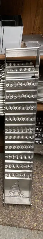

After having used the 12" X 60" sluice for years to catch fine gold. It had never dawned on me that I had never seen any fine gold in the lower 18" of the sluice... ever. In an effort to reduce the weight of this efficient, but heavy monster, I am going to remove the lower two plate assemblies that apparently are never catching any gold. If I am not loosing any gold, why carry the excess weight? Your thoughts and/or experience are requested. Image below shows a 12" X 36" Gold Well.

I would run it both short and full length and collect and test pan samples from their tailngs.
Gold in both could indicate the need for a secondary recovery sluice. A drop riffle or vmat setup may meet that need.

Just turn it into a flared 36" and sell the other 36". The Gold Well works fine on its own.
This is exactly what I am doing. I am classifying the feed with 1/8th inch perforated metal to make certain that I don't bounce the fines off of the sluice. The proposed size of the perforated metal screen is at present 4.4 inches X 8.5 inches. Hopefully, this will permit the smaller sand and gold particle to be separated from the mass.
