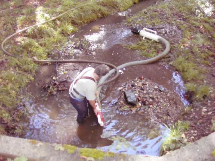

The Gould gold dredge seems to be a quick light setup, has a fine gold recovery rate..Why isn't being used more in the streams?
I thought most of the gold in fast running streams was fine gold. The gold in the Northeast is mostly fine to flour gold. It seems most high bankers and dredges move the material through too fast to get the fine to flour gold. Maybe the romance of the nugget overwhelms the practical collection for money.
Has anyone had experience in the NE using a Gould type sub-dredge?

i havent heard any replies for Goulds devices. people just are tight liped about these things.i really like his work on this stuff and wish someone that has bought and used it would post a reply! other wise it looks like if you want one, youll have to buy it and test it yourself! im NOT saying anything (good/bad)towards Gould devices, but this type of device (other manufactor) hasnt had a good results on them for fine gold retention!
BAMBOOZLEAJERKA seen,tried,laughed get a real dredge even a keene subbie whatever-John
Hoser John-How did you test the Gould dredge? Were you in rivers with fine gold? The laminar flow and centrifugal spinning of the water inside a submerged collection area would lend to a good collection rate. The pictures of the Kenne subbie look like a Gold cannon type sub dredge with a small tail end gold collection port.
Hoser has more true experience in mining equipment that all of us on TNet put together! His mining supply (PESCO)store made and tested equipment since the 80s. questioning John is not a smart thing todo unless youve walked the walk!and not many of us have!
Ive never tried one, but I can say that over the many years they have been around, I have never heard an owner brag about their fine gold retention. I have heard far more unhappy owners than the other way around.

I'm trying to get very fine gold 200-mesh. I've watched the guys using regular surface dredges from 2-4"-yes they are getting some nuggets, pickers and flakes. I see some coarse gold in their daily takes. However, the streams have this very fine gold. It looks as though this gold is being shot back into the streams. The flour gold gets caught in the turbulence of the uptake and also gets caught in the air/water interface(surface tension). A sub surface dredge would eliminate this interface.
Each set of equipment has its use. I've tried the slits in the bottom of my sub surface dredge and it works. The very fine gold settles and falls through the slits and we have got fine gold, small garnets, black sand and some material that looks like electrum. I working in areas that have no big gold. I wanted to know how the Gould Bazooka dredge with its centrifugal forces inside the catch tube work for people in the field. Even though it has a rear end nugget trap..I don't think its original design is to get the big gold.
The gold cannon is being used in areas of very fine gold and I the machine was made for the area.
200- mesh needs a hy-g, knudsen, knelson bowls or fluidized bed jigs for recovery. GOOGLE and explore real equipment-John
