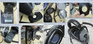

I just bought a set because they are the better of the two offered out there.
But these HeadPhones are to Quite. I can barely hear them in the house never mind near the surf.
Did you guys figure out a way to make them louder?
They fit great but I BOOSTED up my Volume GAIN on the CTX to max and it didn't even seem to matter still to quite.
Want to get these working because they are comfortable and don't fall off my head like the stockers do.
And from what I have been reading the MINELAB water proofs are to quite too so I am thinking it is the CTX with the issue.
I bought a set of Grey Ghost with my x-terra 705. I am also disappointed with their performance. I only have limited volume adjustment, that is, I can only hear anything on the last 2 detents. I have complained to both the dealer and the manufacturer and neither has acknowledged there is any problem or tried to address the issue. I will never buy any headset in the Grey Ghost line or recommend them.

I was hoping maybe there was some way to fix them. Hell I would even send them back to have them fixed right so I can hear them. I have sensitive hearing too and usually run my detector a little quite. But this is way to quite to even hear smaller targets or deep targets.

They have a univeral tranformer in them to make them work for all detectors since some Detectors are AC and some are DC current output. Best thing to do is gut them and put skullies UW speakers, I have done 5 sets now for unhappy GGUW owners, increasing audio to 70 percent better. The last set I did for a CTX hunter this is what he said...Night and Day difference, now I'm doing his 2 excaliburs and a backup set of the GGUW's....

So to fix this set I would have to add new speakers and that is it?
What actually makes the headphones water proof just the GOOP they throw on the internals?
The problem with all manufactors they see Piezo benders as the only alternate. I had a talk with one of the Big guys from one of the bigger detector companies and told them they would start a revolution with the skullies if they would put them on there UW detectors. He said to much work to produce them, I shared the idea of how they were made, his answer...too costly and not time effecient.
If your looking for the best Water hunting HP's, then Skullies are the one's, none can match the performance of the Audiosears 2463 speaker.
Goretex and aquaseal for the skullies, GGUW's they use some type of plastic from a glue gun.

For under $60.00 you can buy a connector and waterproof earbuds that are much louder. Just made up a set.
