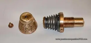

Your Discovery is effectively a WW French Time and percussion fuze. You can find details on my website of
The presence of such a WW shell fuze in Indiana could be the fact WW1 US artillery was in majority delivered by France. Training grounds and artillery proving grounds used such ammos in US during and after WW1.
But your item was modified on a peaceful and pretty common way : the inner mechanism has been extracted and the ‘hat’ has been turned upside down and screwed on the inner column. This is a classical transformation of a WW1 battlefield relic into a trench art souvenir. This item is therefore very likely a souvenir brought back from France by a US soldier who fought there, or a souvenir brought back later by a battlefield pilgrim or tourist.
Here is an image of a similar item I own
