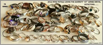

If you like finding rings, the AT Series have done extremely well for me.
