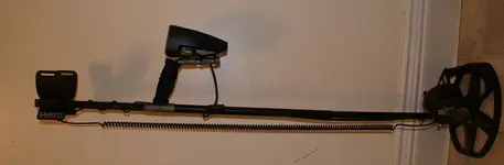

I did this. Why? I dont rightly know I guess.
DSC01363.webpDSC01364.webpDSC01365.webpDSC01368.webpDSC01369.webpDSC01370.webpDSC01371.webpDSC01372.webpDSC01373.webpDSC01386.webp
The arm cuff stick is a fiberglass cz20 coil stick. I drilled a hole to mount the cuff. The mid section is the original aluminum atp tube. The coil stick is the original coil stick on the pro. The grip/brain box mount I fabbed outa thin wall stainless tube. All this gives me a better "feel" in the wrist but not much else that big dd still feels like swinging a brick around.
I really like your idea, did you weld the tube the box is mounted on to the tube in the shaft?
