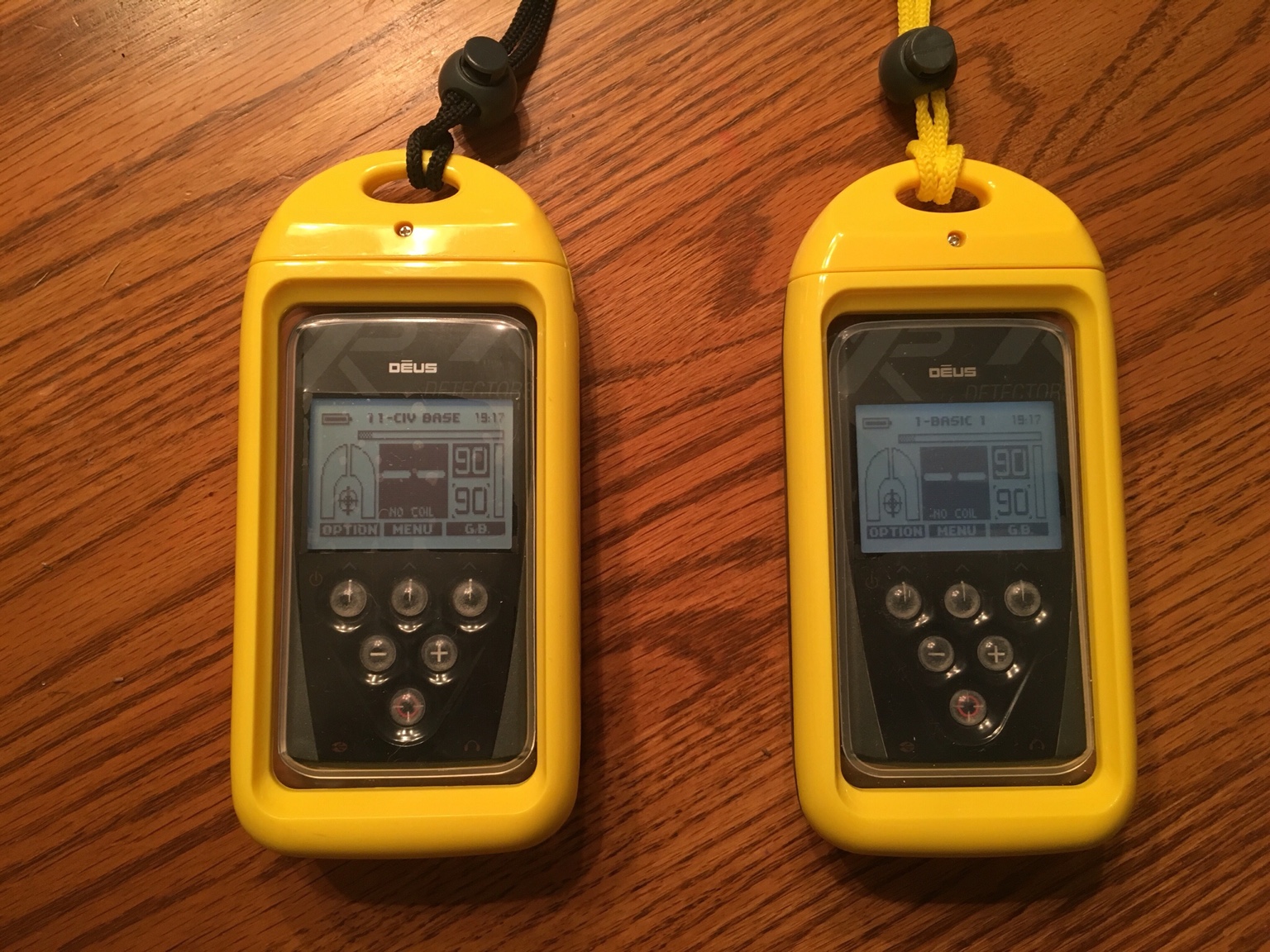

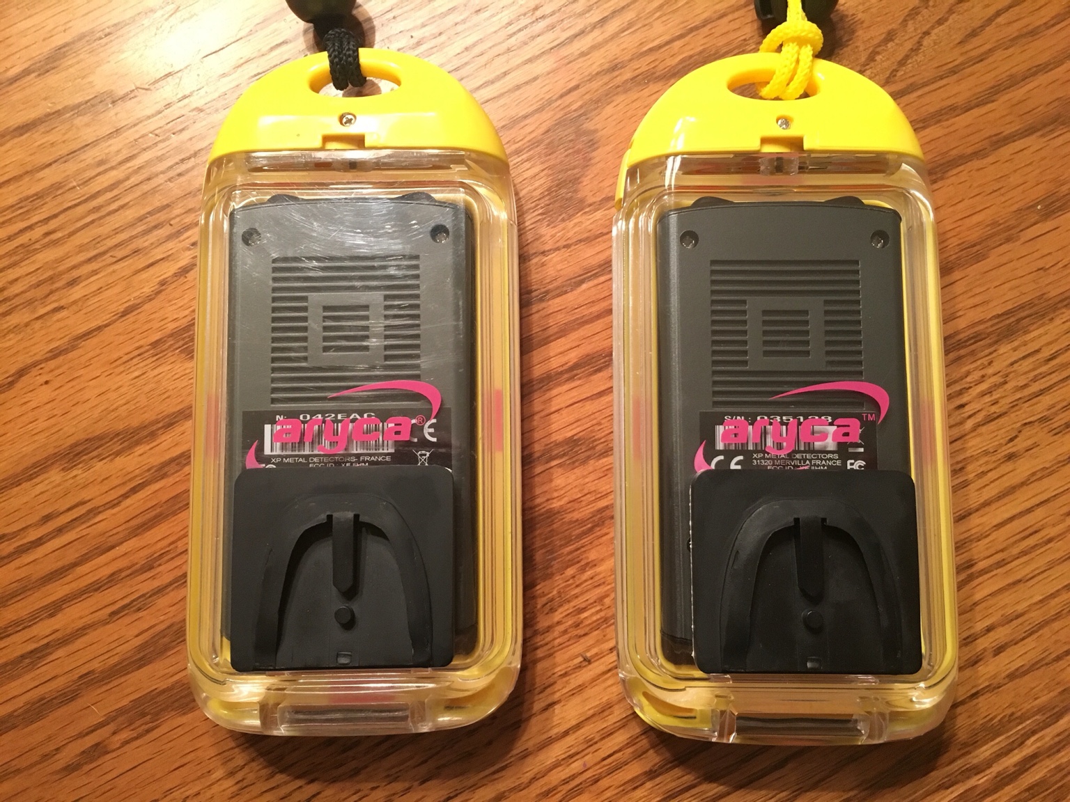

This is the waterproof case I would recommend. It also allows you to press the buttons.

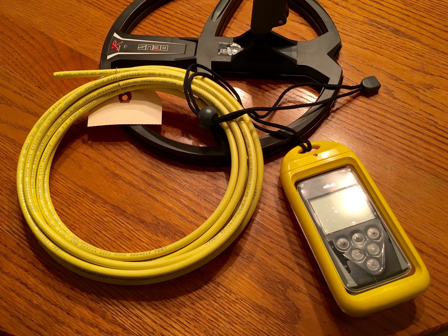

And this will be my home brew antenna between the coil and control box.

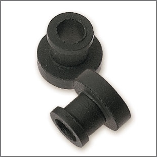

I'm thinking of finding a small rubber grommet like this and siliconing the outside ledge to the case, then have s tiny opening through the middle for the speaker wire, then siliconing the inside of the grommet where the wire passes through.
Idea not fully thought out yet, but when I decide on s solution it will be waterproof.
