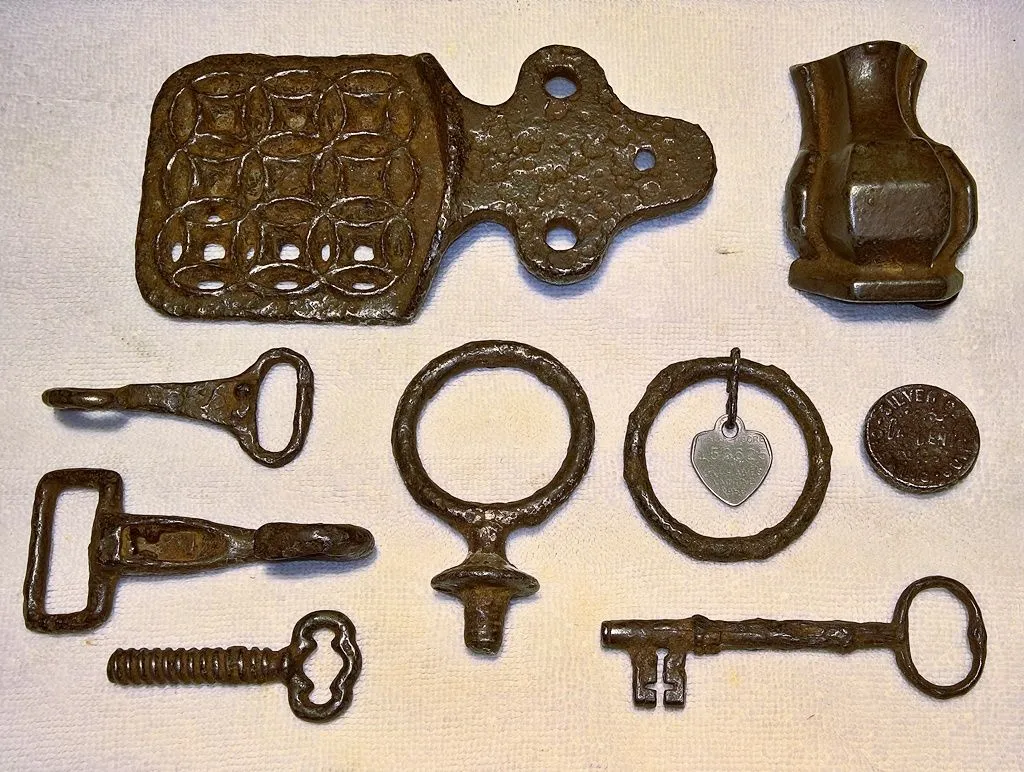

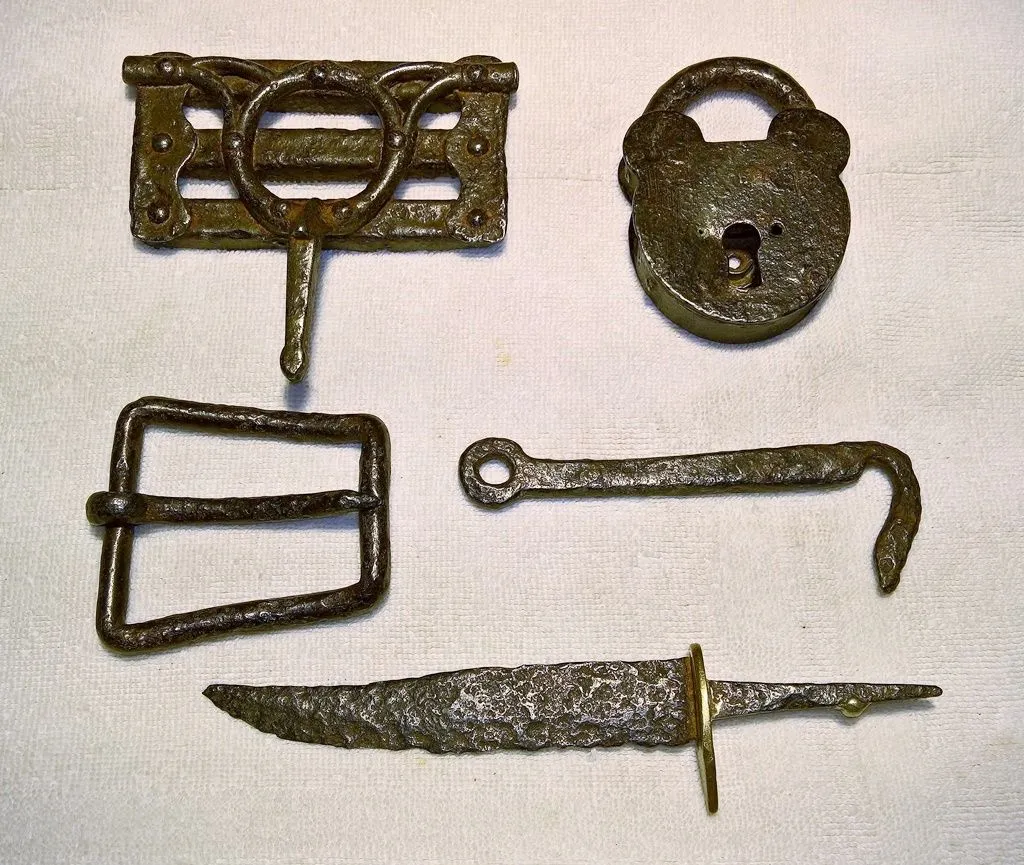

I found an old hatchet last week. Mine is smaller and shaped more like a tomahawk. I had just gotten my very first rock tumbler the day before. So, I used it and I am hooked. The tumblers (I since purchased a double tumbler, so now I have a total of three) do an unbelievable job on all the old blacksmith made pieces.
When I pull them out of the ground around here, they are encrusted with sand, red dirt, rust and are as hard as cement. I've tried apple cider vinegar, evaporust, oven cleaning and degreasing spray, boiling in water, scrubbing with barbecue pit brushes, etc.
The rock tumblers, with pea gravel, water and a capful of Murphy's Oil soap has shown details I couldn't see after WEEKS of fooling around with the other stuff. And they are cheap. A single tumbler is about 49.00 and the double about 59.00; both at Harbor Freight.

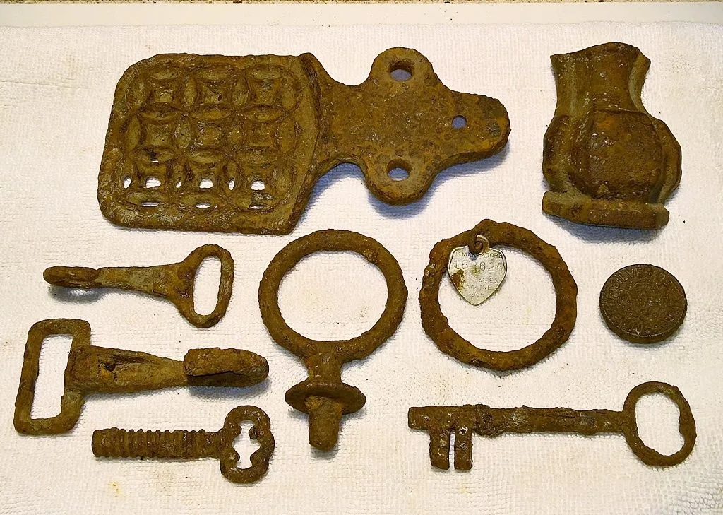

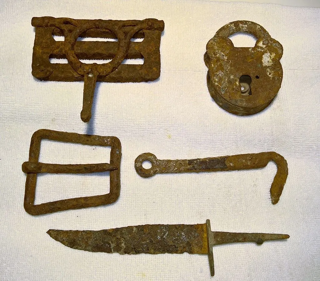

There is no before of the hatchet, but I can show you what similarly made items look like before.

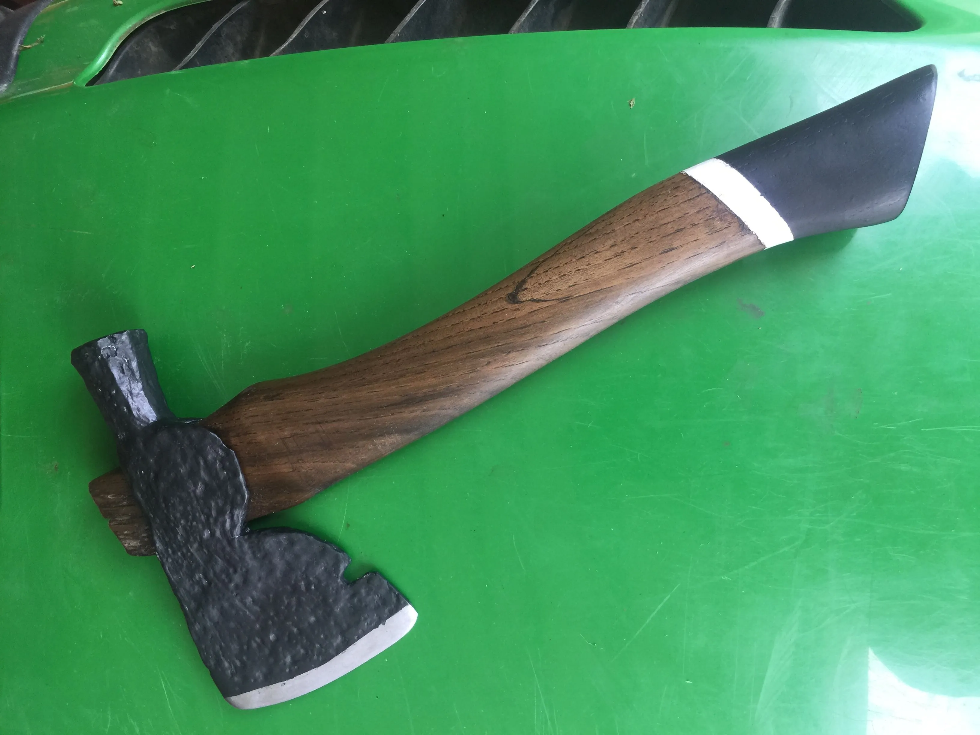

Completed the restoration on Hatchett number one. Found old wood at antique mall guy has buckets full for $4.
Great looking restoration job on the hatchet.

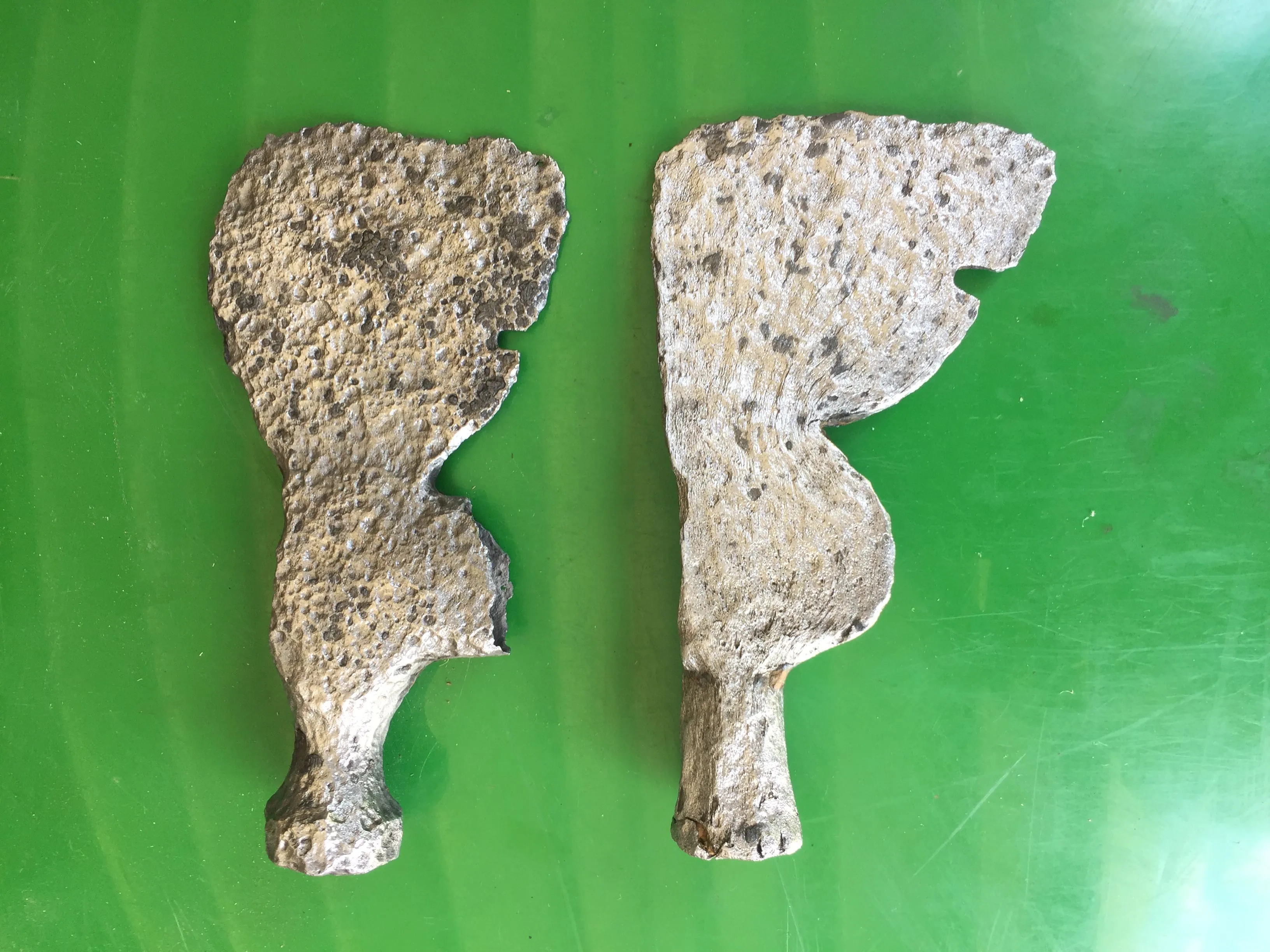

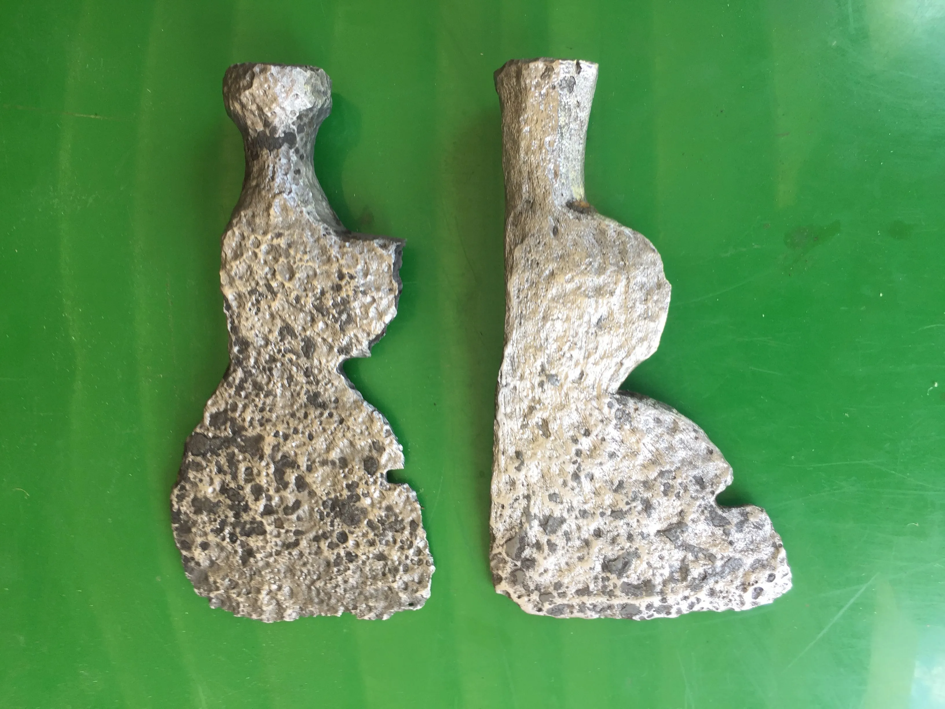

For those who are interested, here's a link to a post I made in January detailing the tumblers and the 'recipe' I use for tumbling.
http://www.treasurenet.com/forums/r...23998-next-batch-tumbled-2019-iron-finds.html
Also, here are some before & after tumbling results from 2017. :thumbsup:
Love your results on that hatchet restoration too buddy!
Dave

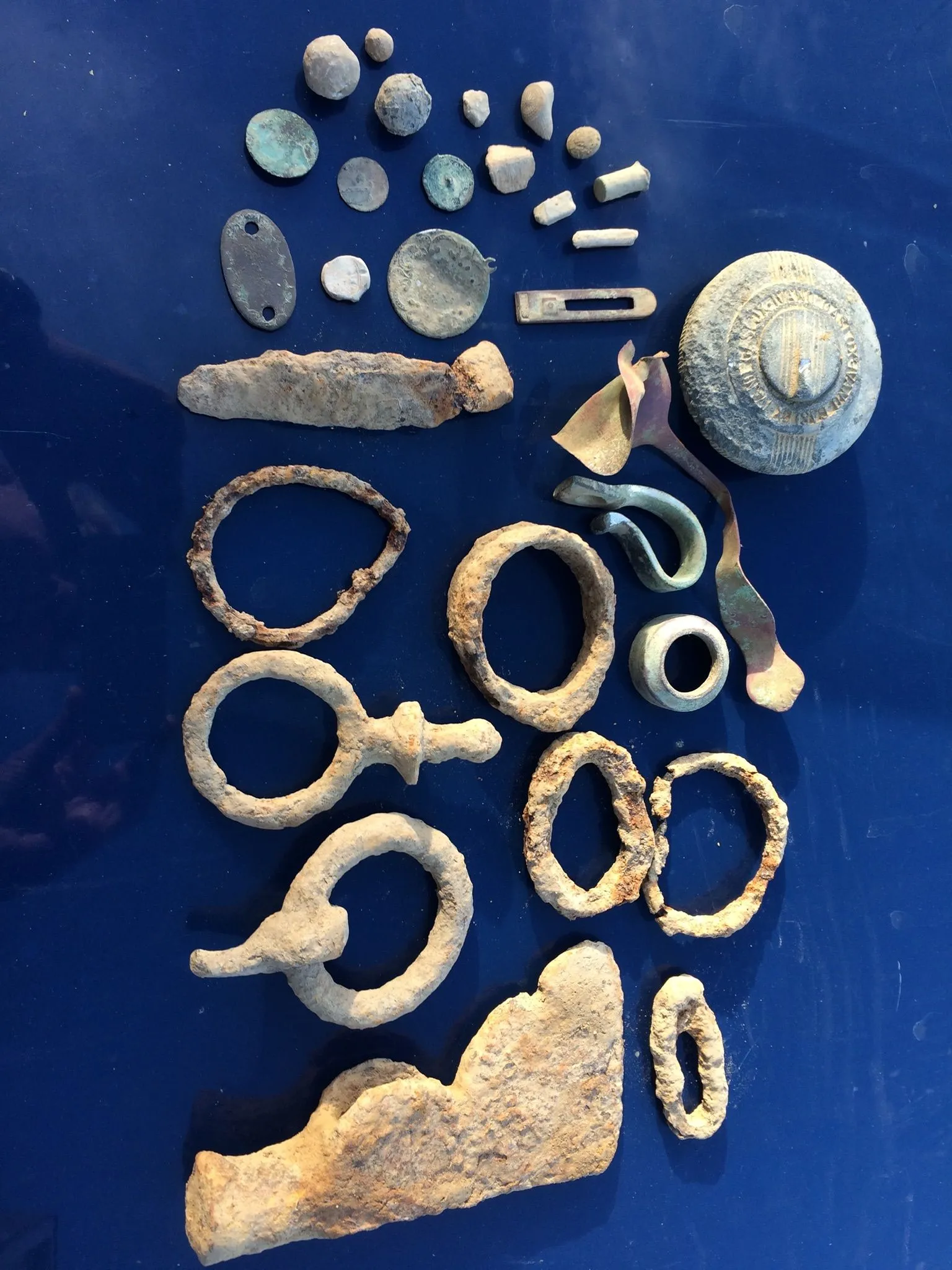

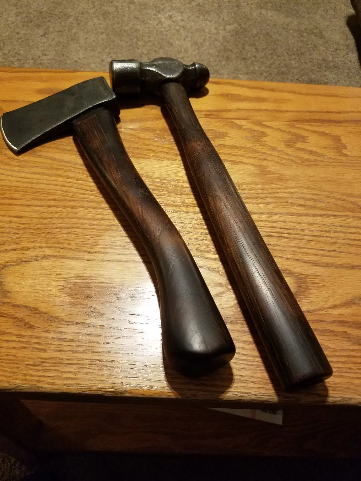

I’m pretty new at this metal detection thing, but hatchet restorations have been my thing for a few years now. If I can be of any help to anyone here, feel free to tap me on the shoulder.....E20270CA-DF36-4270-BACB-EE93683C2289.webp
