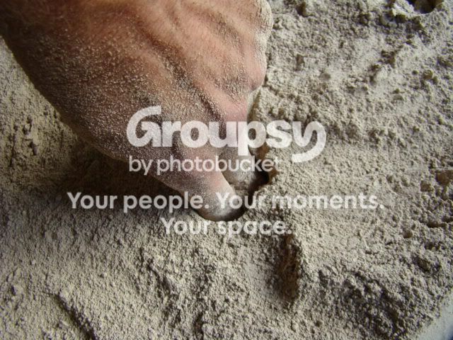

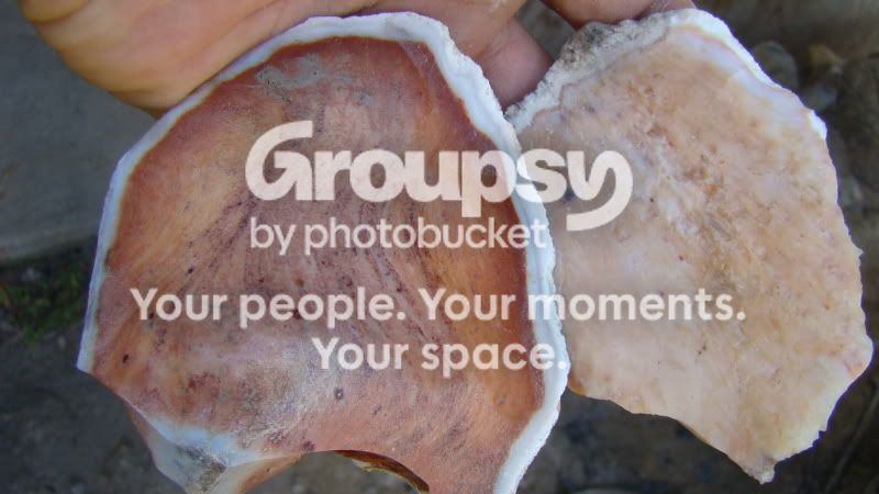

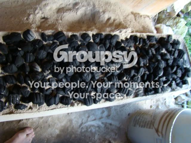

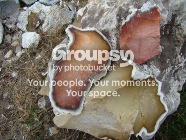

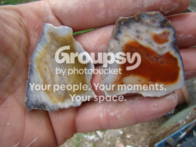

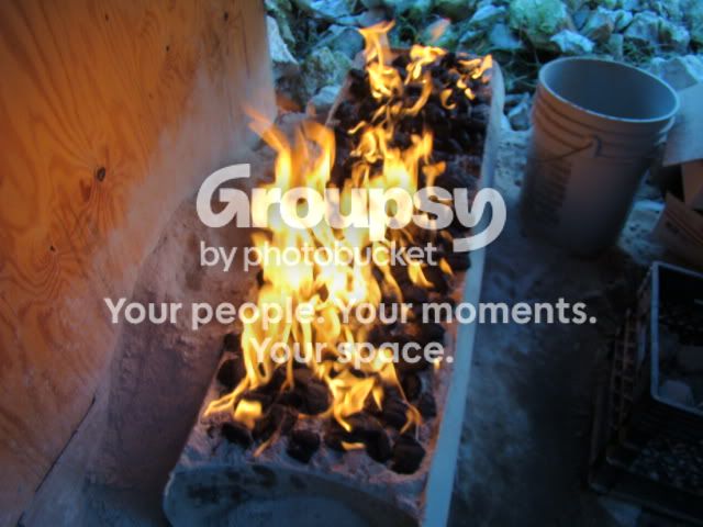

I cook my coral all the time, I sell alot of it to the flintknappers but I love to work it when its cooked, I cook alot of brazilian agate also, saves my wheels. If you have a kilbn try it if not and your not familiar using the charcoa method, get an old or a cheap turkey roaster that goes to at least 400-500 and take the pan out and fill it with sand and put your spalls or slabs in there and hold it 200 for a few hours and ramp it up to the max and hold it.
What is the purpose of cooking agate, coral etc? Just curious.
It puts in color. Sometimes it is wanted, and sometimes it is not as planned. You have to be used to what heating can do. Saphires are often heat treated, to bring out the colors.

yes it does, the paleo indians didnt have heat treating technology it started in the archaic ages. It does change the workability of the rock. Coral is a 7 on the mohs scale of hardness and is a bugger to knap raw, hinges, tears etc. when you cook it it glasses up and your flakes run across and works alot better.
