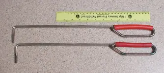

I have special tools that my partner made. They are "handled" shaft hooks in different sizes and lengths. I gave Clay a whole box of larger ones. I use a sand shrimp gun. It will suck out cracks that are in some water and it will also fill with water and allow you to shoot the water into a crack/crevice and blow the material out....then you suck it up. I have made a few hooked tools out of heavy duty screw drivers; but my buddy makes some handy dandy tools. On dry bedrock cracks I use the same crevicing tools but I use a (elect or gas) vac to suck or blow the material out of the crevice. Clay might take a pic and post it.
Bejay
Clay might. :thumbsup:
A couple of these, a spoon and a shrimp gun will handle 90% of situations. Another 5% would best be handled with a rock point and a singlejack.
