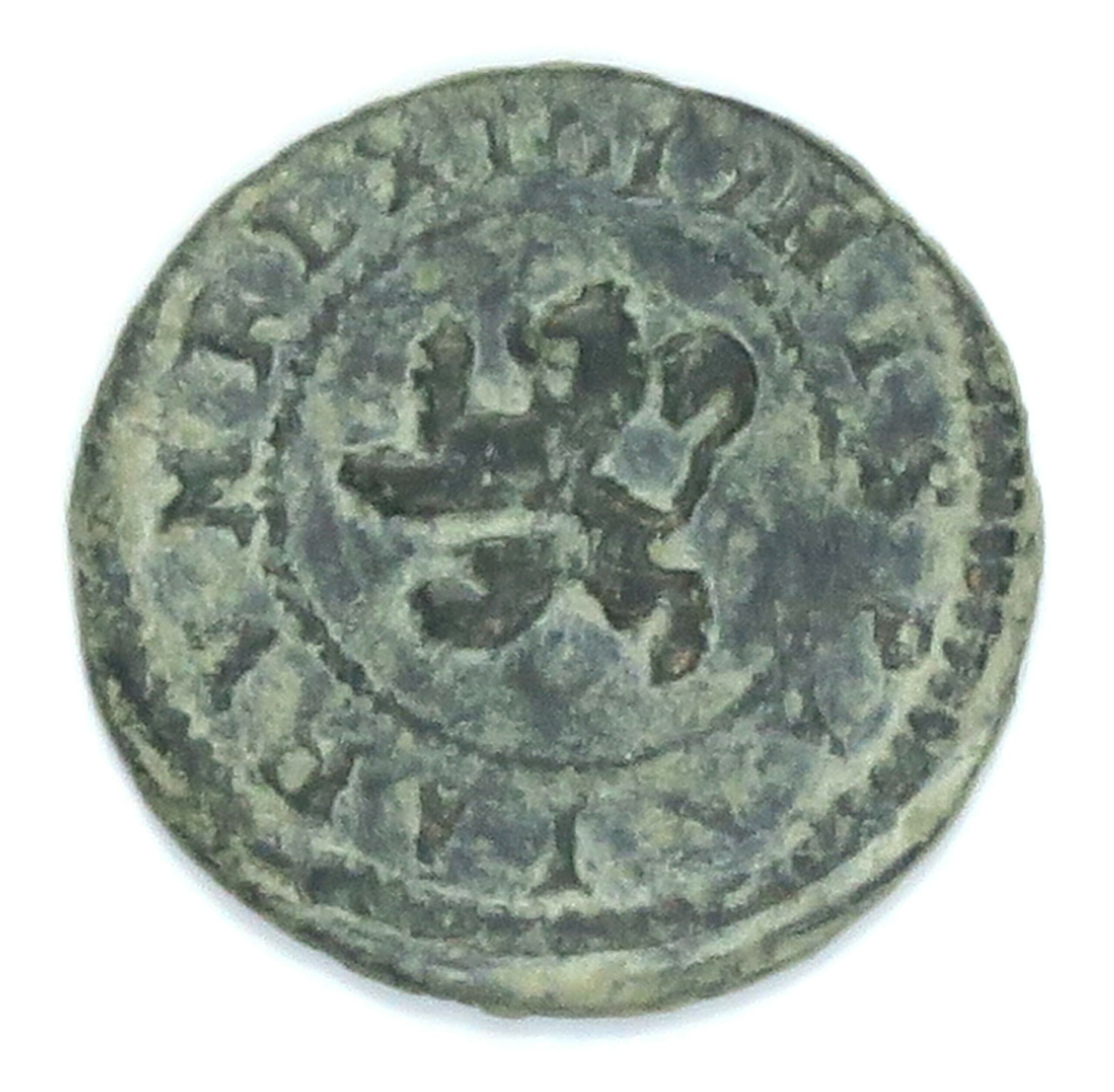

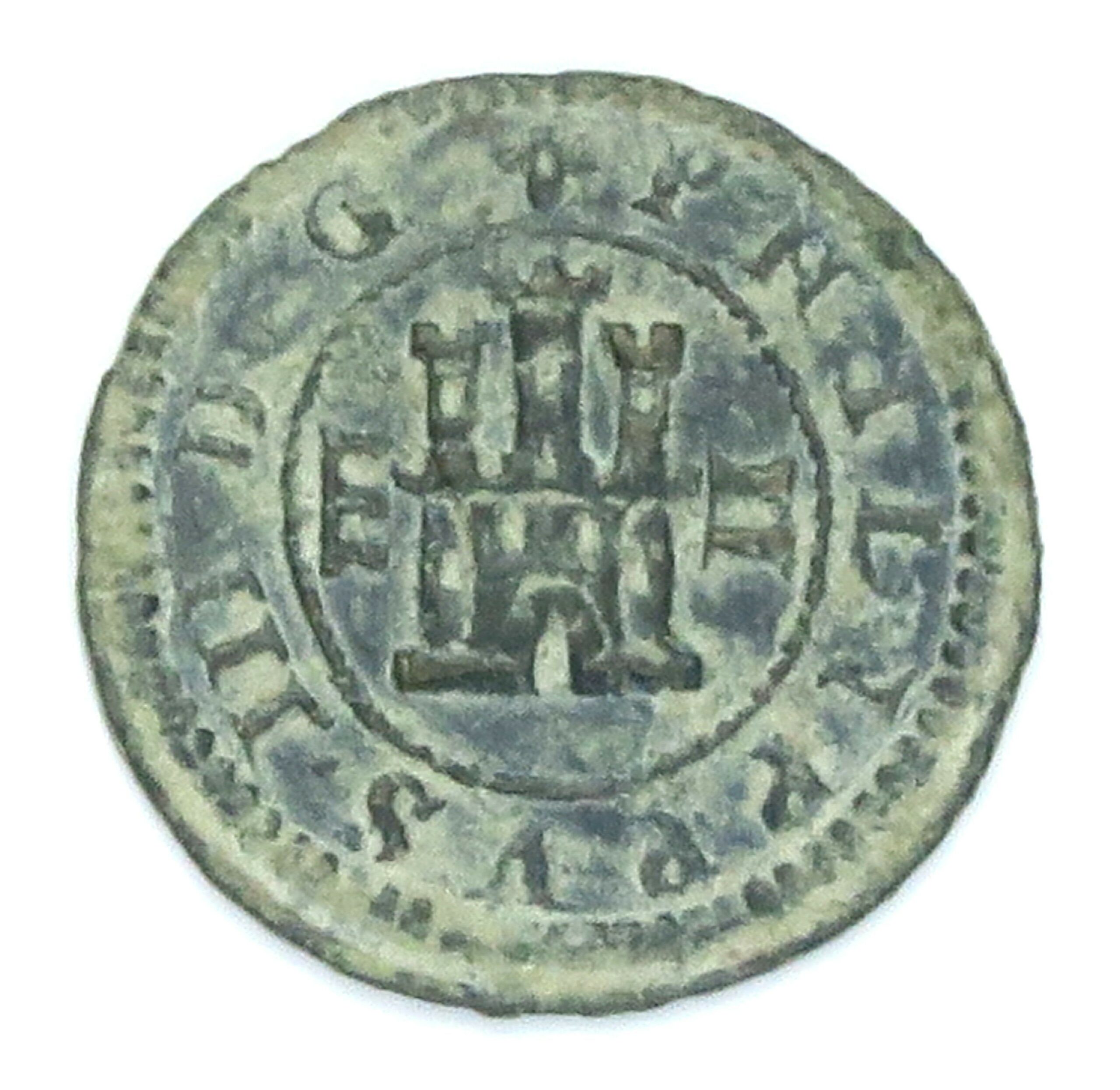

I have several 17th Spanish coins that I need help identifying.
Thanks!
Scott
Notes:
S1- 23mm. 6.6g.
S2- 17mm. 0.8g.
S3- 16mm. 1.0g.
S4- 17mm. 1.2g.
S5- 17mm. 1.6g.
S6- 16mm. 1.1g.
S7- 15mm. 0.9g.
S8- 20mm. 2.8g.
S9- 18mm. 0.8g.
S10- 23mm. 2.0g.
S-6
Two-maravedis copper coin of Philippe III, 1598-1621 AD. Segovia mint, dated ( I believe) 1602. Castle, inscription "PHILIPPVS III D.G" / Lion, inscription "+ HISPANIARVM REX 1602". Aqueduct mintmark.
S-9 will have in it's description: 'Castle in octolobe' and 'Crowned lion (or rampant lion) in octolobe'--found frequently during the reign of Philipi III (1598-1621)

Scott,
Apparently, the experts are choosing to just lurk. I thought my somewhat vague (or inaccurate) responses would have baited them to respond, I"ll continue to stumble on as time permits.
Don in SoCal
#7 similar to this one: 1566 Spain Coronado Castle Monogram Coin - Philip II

The maravedis coins that show the aquaduct and lion were minted during the reign of Philip II and III and perhaps others--making them difficult to attribute in the condition they are typically found.
Don.....
