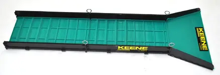

I recently removed the metal riffles from my 36"x10" high banker and replaced them with the keene matting. Im getting a lot less cons which is nice but im not sure if this is the set up I need. im running a 3700 gph pump and 3"s of drop. materials are classified down to 1/4". what should my water depth over the matting be and is it going to have a fast enough exchange rate to capture gold if I run 5 or 6 5 gallon buckets in a single run. im new to the sport and have a million and one questions any help is appreciated.

Are you guys talking about the Keene Miracle matting?

I was under the impression that my Keene A52P had the miracle matting, but upon closer examination it appears slightly different.
And it's green :laughing7:
