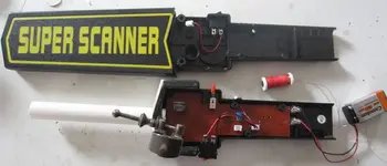

With that in mind, I wondered if it was possible to turn one of those security wand detectors into a pin pointer.
Enter the Super Scanner, seems to be a cheap BFO (MD3003B1) just 3 tiny transistors and a 78L05 to get 5V for the LM358.
So far just testing the open coil and pcb on the table seems promising, I wound a 8mm ferrite with 5 layers of 0.28mm enameled wire and it picks up a small 1948 silver tickey about an inch away.
Nice thing is, it has piezo buzzer, sensitivity switch, vibrate and led, all with a rechargeable 9V battery.
