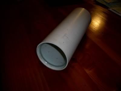

next project will be an underwater viewing scope.maybe -4" pvc, 20" long, plexiglass lens with a coupling and vent holes for air .i believe i will add a light ,and have possibly a magnifier that can be removed.(to many years welding don't see like i used to)---plus that way if i let some one else use it-i can take the magnifier out! (can't give em an edge! :laughing7: :laughing7: :laughing7:) but seriously this could be a great tool for those shallow bed rock areas that i love to hunt. i have also seen one made to put on the crevice tool for a hand drege application.it was 2" ---seems a little small to me to be looking thru -3" would be better for that.once i make my 4" model ,will post pics.

Gday Strickman, Here is an under water viewing scope I made with a 4" PVC pipe. Just silicond some glass up inside the end. Works bloody great :thumbsup: :thumbsup: :thumbsup:
I took a photo through the view finder of a couple of pieces of gold on bed rock that I uncovered. Only the camera focused on the glass in the end of it & not the gold so the gold is a bit blurry but I am sure you can make it out.

looks like shine to me !!!!! thats what i'm making next,i found some led lights that clip on a baseball hat i plan on mounting these in the tube :sign13: might help . glad to hear you chime in ! keep it up...also planning on making a mini highbanker-or should i say low-banker,,, for using my mega sucker . think i might use 4" corugated pipe and a small grizly .that way i can leave it hid with no worries. lets see some more ...
Strickman, just a suggestion- on the scope. Use 4"ABS pipe, the black doesn't reflect light as much as white does (can see target better). Go to a glass shop and have them cut a round lens out of 3/16 or 1/4" glass, will not scratch up like plexiglass. Use a 4" colyer (sp?) rubber coupling w/ hose clamps and help seal w/ silicone. Handle is 4"x4" 3/4" angle bracket hose clamped to tube, slice the end of a broom handle, slide it over and secure. The one I made 25 years ago still works fine.
Don't know if you'll need a magnifying lens, I never did.

Got too long winded. On first post you might of though, the glass in the scope might break if hit; never has for me in many years. The screwdriver and sniffer fit into the scope till needed, very compact and easy to carry for sniping.
Shep
the abs would reduce glare,i was going to spray paint black.might be more trouble to paint inside.abs might be better.i also found that a large gasket pick works well for cleaning cracks i think i paid $2 for mine. great ideas shep keep em'coming.
