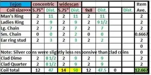

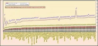

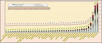

Here is all I can find but would like something like the first pic vs the 2nd pic over the competitors as well though including most Tesoros I found some images on Google by John Hampshire the author. The third chart would be nice to add all the Tesoro's relative to price there is an empty column one can add to this and start there own from this one if they like, as I see some people out there with multiple Tesoro's they can build on this and please share with the rest :)

Bottom left one shows that could.padre ranking really high!!
That one chart is great with the green bar graphs. If course I must say my Silver umax I gave does not beat or equal the Tejon, Cibola, or Vaquero.

Yeah I was looking at some of those numbes on the green bar chart and I was thinking there would be some debate over the depth in the comparisons not to mention the coils one would use I could see some going higher then that and imagine these are not considering any Super tuning and would like if it were in All Metal Mode, doesn't say and look at line 130 which wide scan size are they talking about as I would imaine if it were the RSD 11x8 put up agianst the Vaquero Web Coil, wouldn't you think it would beat it??
