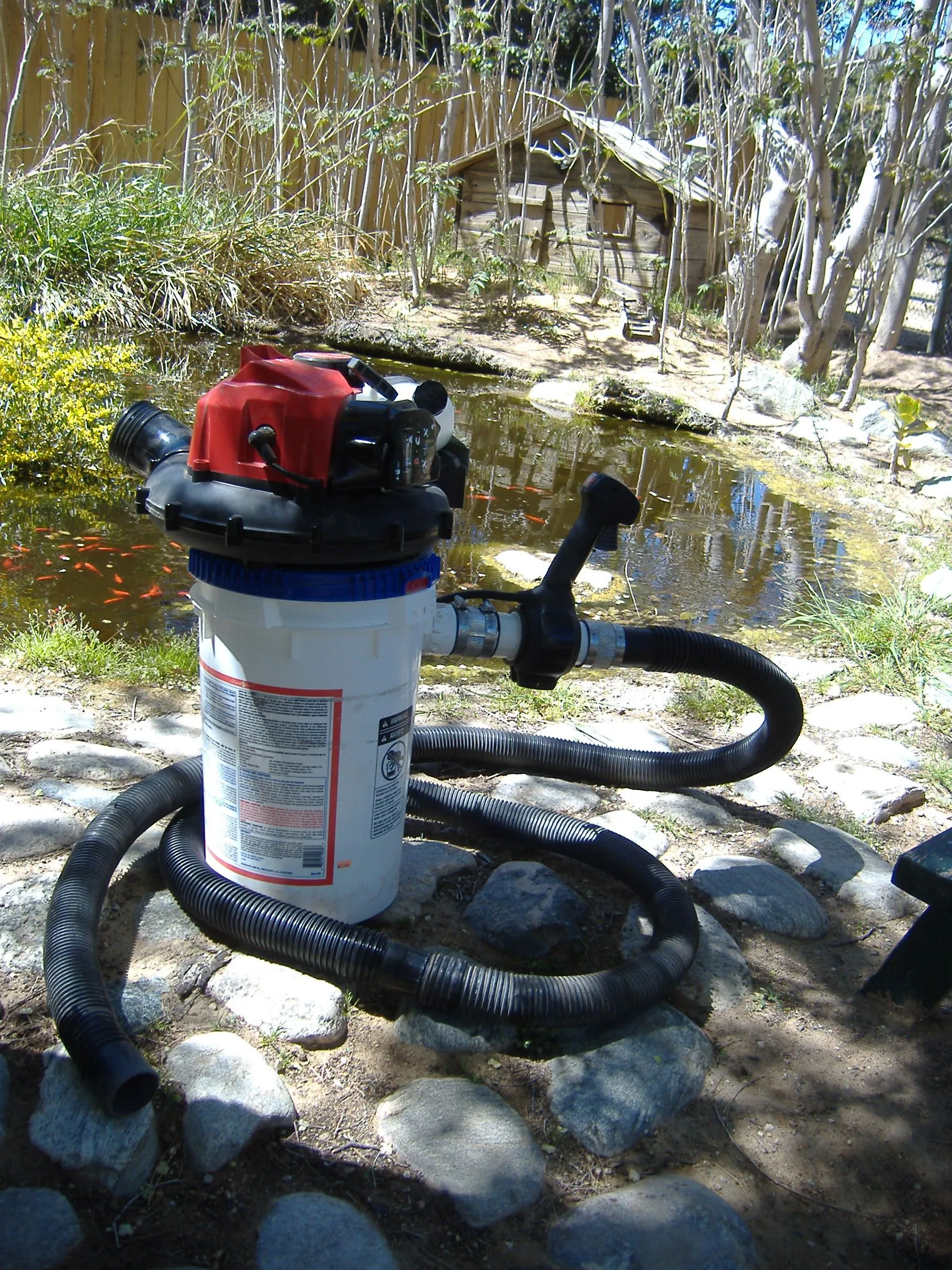

Resized_20210401_103308.webpResized_20210401_103314.webpi know ive brought this up before,but everytime i use it it reminds me how much it hate it,if you use pump gas and 2 stoke oil, the gas kills all the rubber parts.so i buy tru fuel at 7 dollars a qt.it works ok.the only part of of this vacuum that does not suck ,is the part that is suppose to suck.why do they use a corragated hose,great place to cause a jam. ok now i feel better:laughing7: so would a smaller smooth bore hose work better.i know it wont be as flexble ,but my kinks anyway. any ideas to make this dam thing do it job better,i hate leaving dirt in the bottom of my holes or in cracks after dry washing.

If what you are using is in the pic, then that small crack nozzel is the issue. It is restricting air flow and material is building up in the hose. If you need to use it in cracks, pull it off ocassionaly to give your machine a breather.

Smooth bore hose would reduce the internal friction which would boost the suction but reinforced smooth bore suction hose is not cheap or as flexible and will not come with vacuum fittings.
Lay flat would definitely not work as a suction hose. It's obvious from the photo that you could use a new hose, I would not reduce the size though.

i think we have a winner.its funny that pressure likes to be necked down.but vacuum is reversed. thanks for pointing that out,i wiil made or buy a bigger nozzel.and a smooth bore hose of the same size.and test it next week.

I would say...keep your old hose and work with the nozzel. You will be unhappy with smooth bore.

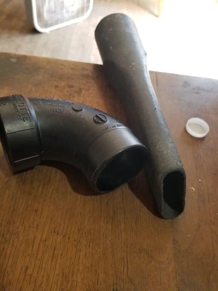

Resized_20210402_141038.webpso i got two of these pvc 90s,i may try to heat one up and flaten it for cracks.3 dollars each

I was just going to suggest a piece of pvc tubing. I like working with pvc. With a heat gun you could carefully and slowly give it a slight bend and slightly flatten the end for a tip. I made a great hand sucker with a 3" barrel.There some dry vacs out there for prospecting. What do they use for tips? Good luck with your project.

Corrugated hose...It worked best for the suction end and anything else will be a PITA to work with. At the end of the day you will have sucked up 20-30 gallons and 1 cup is stuck in the hose...but it is still stuck in the hose. Just shake it out and you got it all

The biggest problem is that we need more suction power than these small gas vacs can deliver. When it comes to vacuuming the heavy gravels, hematite, magnetite, gold, and dense sand found in the desert we need all the suction we can get. When you add a kinked hose with a rough inside surface to the mix it just compounds the problem.
Dredgers would not think of using a corrugated hose because it would decrease performance. The main reason dust vacs use a corrugated hose is for flexibility, and those type vacs are only made to collect dust, lint, hair and small household debris, not the heavy dense gravely material that we are using them exclusively for.
I think we are stuck using and replacing as needed the wet or dry vac hose that comes as standard equipment. The flexible dredge hose I have used underwater would never hold up being drug around and over sharp rocks, and the smooth wall suction hose that would hold up is just too stiff. :BangHead:

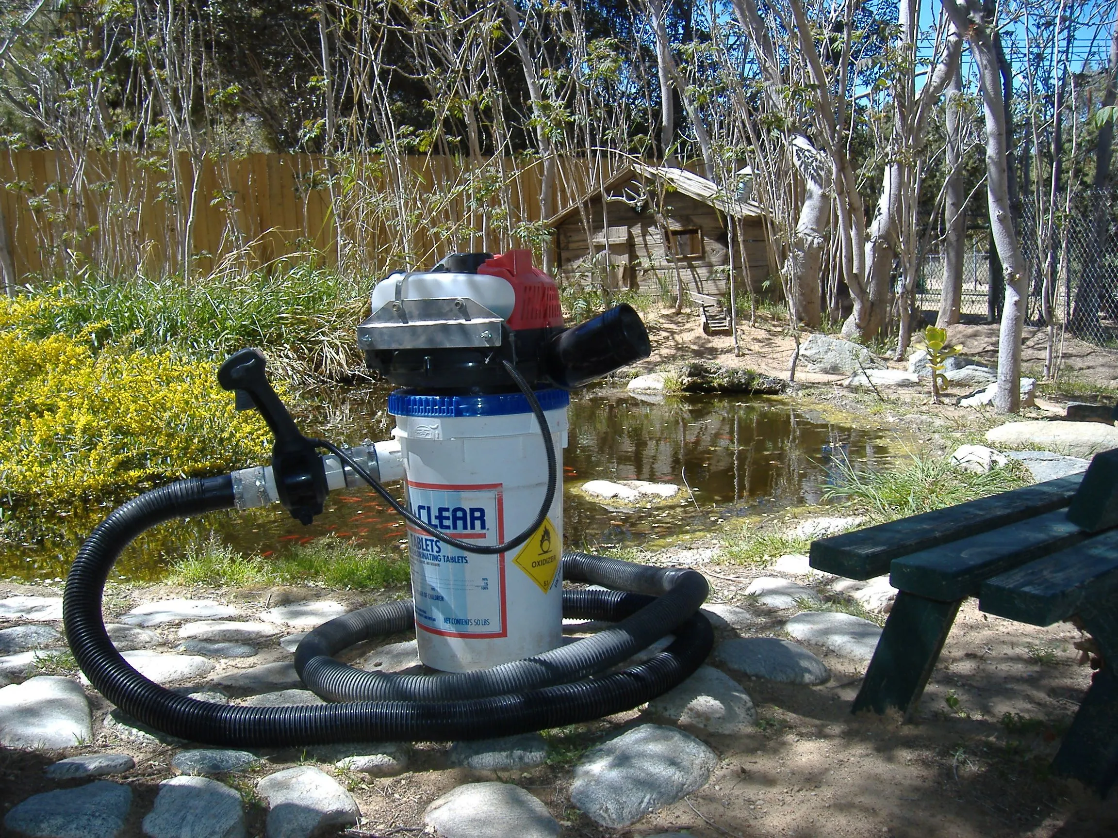

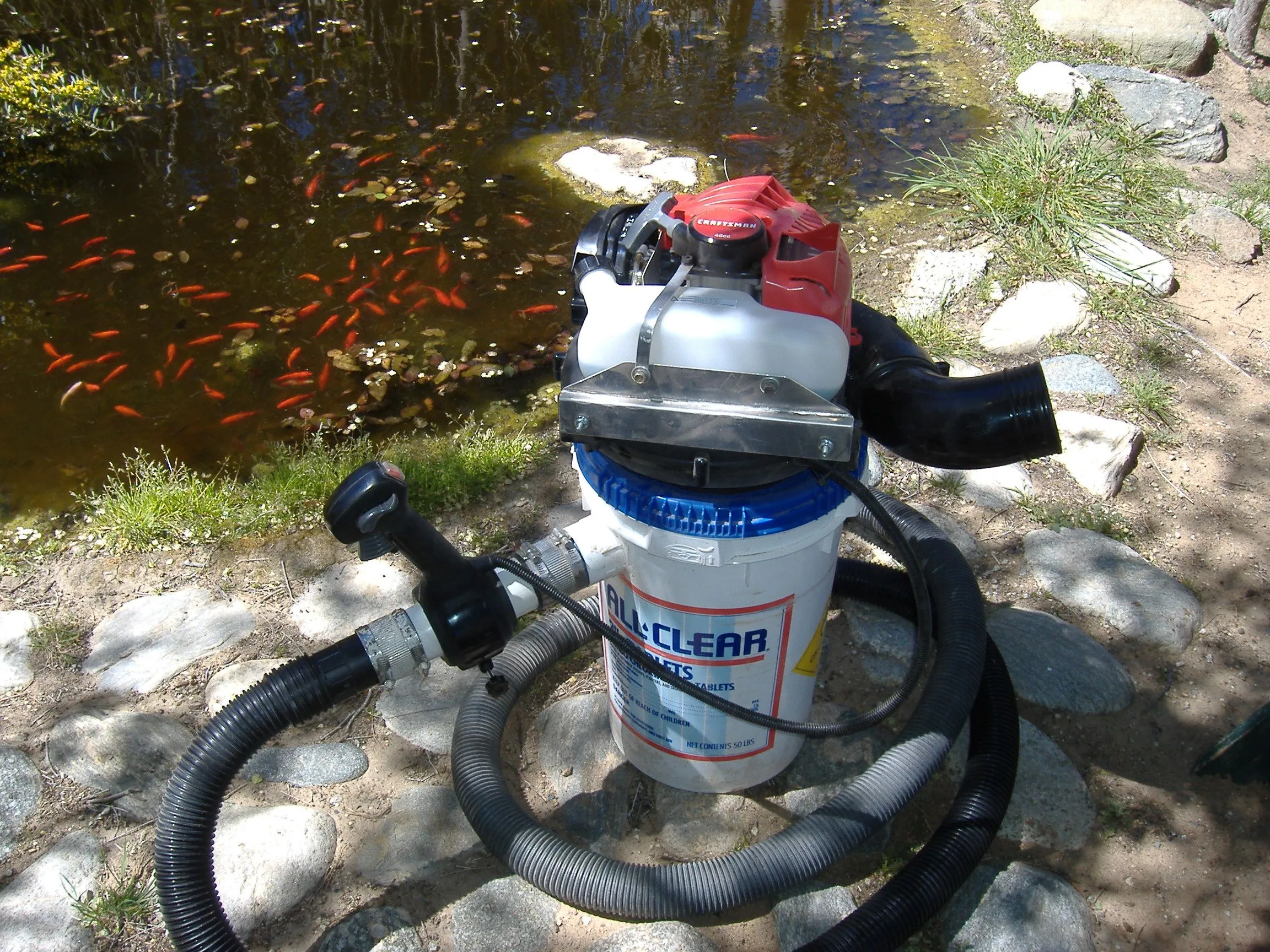

I have found a solution to my suction problem , It's not quite as big as Goodguy's 6.5 but I can still carry it , & it will pull appx. 4' high depends on to rock size/shape , I can also use a longer hose 12' and do not have to move it as much.
most Vac's are only about 23-25 cc this one has 46 cc so I do not have to run it so fast to get good results .
