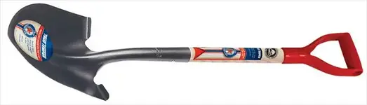

$12 at Ollie's Bargain Outlet.... True Temper always has stock over-runs
